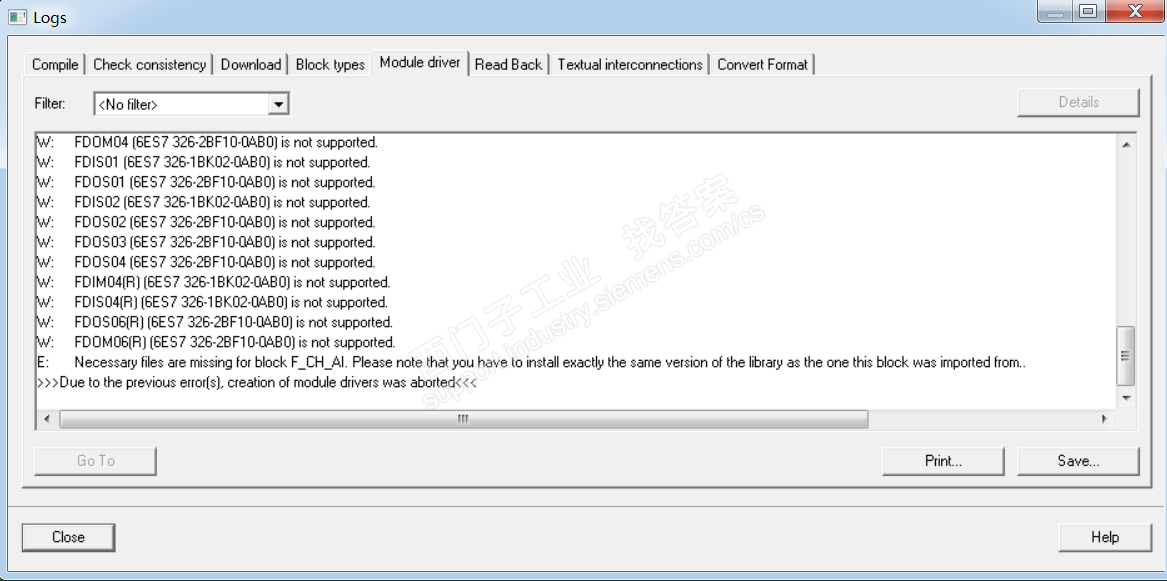

PCS7 V7.1 F系统升级V8.1,安装S7 F-Systems LIB V1.3库文件,编译报错:Necessary files are missing for block F_CH_AI.Please note that you have to install exactly the same version of the library as the one this block was imported from.请大神帮忙分析原因
问题补充:
谢谢紫方回答,英文回答: If that didn''t work, you should probably also delete all @ charts in the charts folder and if that still doesn''t work also delete all blocks created by the author ES_MAP from the blocks container.请问@ charts是不是系统自动生成的诊断功能块,不影响用户逻辑功能?

1, 既然是PCS7升级,那么原来的F版本是多少?升级首次写的比较详细,应对不同版本的F升级至S7 F-Systems LIB V1.3

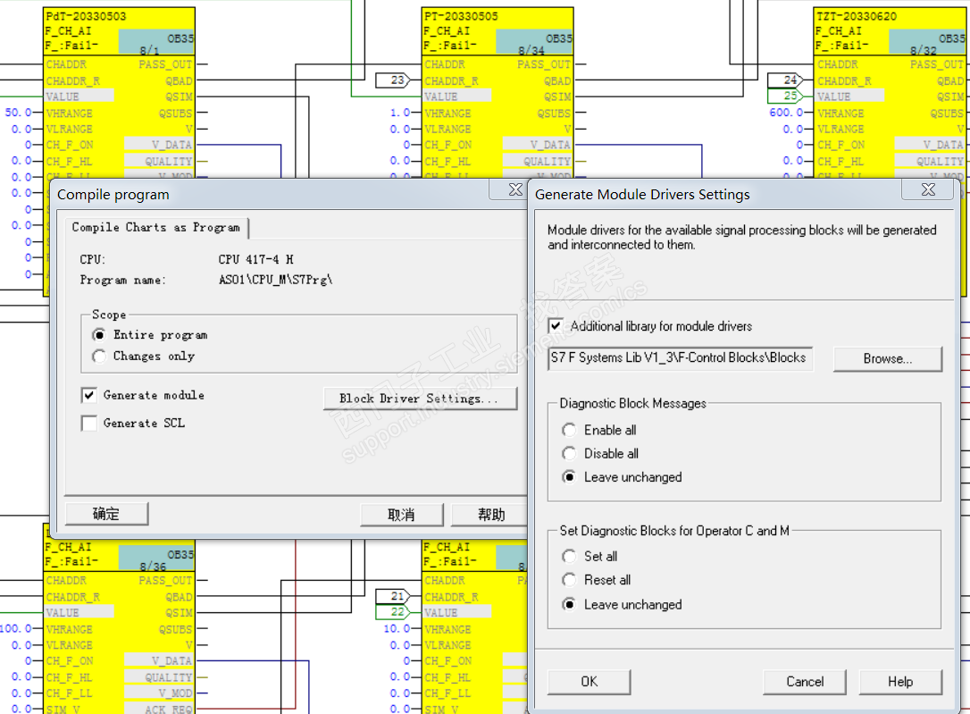

2,另外你编译的additional library 不选择试一试?

按《S7 F/FH Systems — 组态和编程》升级步骤一步步来就要可以了,谢谢
在将某一具体项目升级到 S7 F Systems V6.1 时有两种方案:
1、不进行 F 库更新
2、进行 F 库更新
具体移植步骤参考手册中的移植章节(中文手册的2.3章节)
https://support.industry.siemens.com/cs/cn/zh/view/2201072
3、@开头的CFC是CFC编译的时候自动生成的,如果删除了 下次CFC编译的时候选择生成模块驱动 这些会自动生成的。
