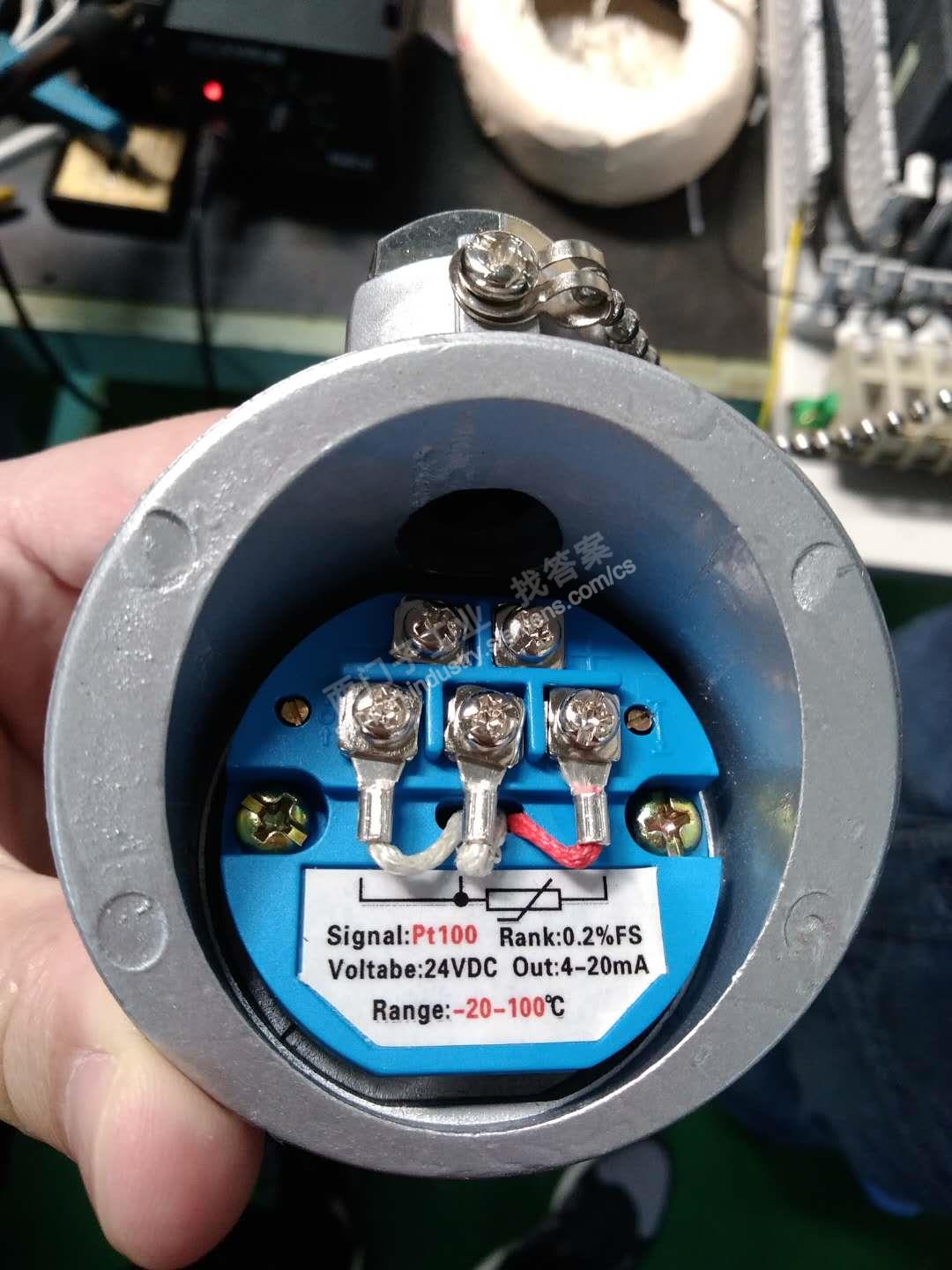

温度传感器PT100+变送器模块,模拟量输入电流信号4~20mA,电压24VDC,测温范围-20~100℃(可定做),200smart模拟量模块可选EM AE04。
S7-200 SMART模拟量模块接线:
http://www.ad.siemens.com.cn/productportal/prods/s7-200-smart-portal/200smarttop/in_out/Diagnose/analog_wire.html
S7-200 SMART模拟量相关资料:
http://www.ad.siemens.com.cn/productportal/prods/s7-200-smart-portal/200smarttop/smartsms/028.html
