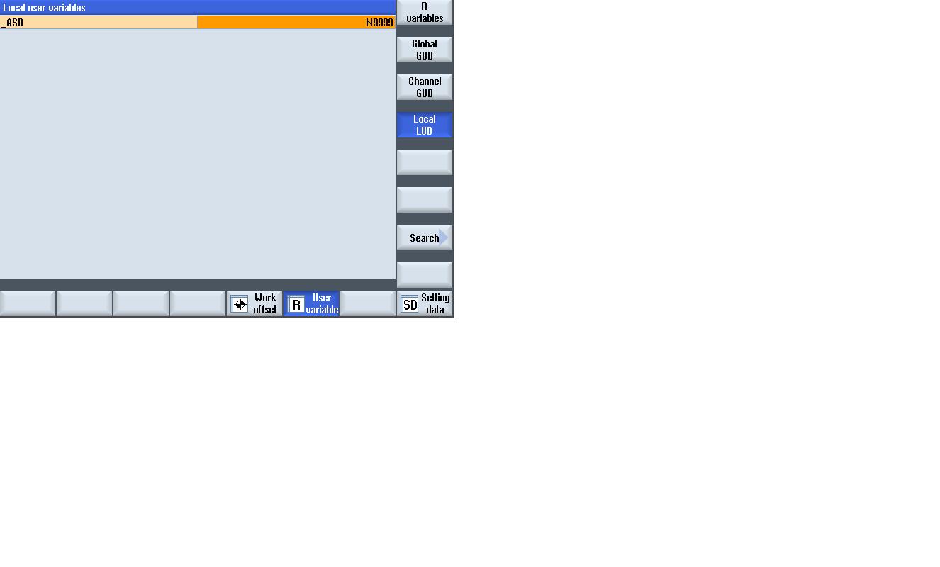

试验:
系统变量
$P_BLOCKNO[n]
Supplies the last programmed block number of program level n.
Example:$P_BLOCKNO[0]
Supplies the modal block number of the program on program level 0 = main program name.
MD 10284 $MN_DISPLAY_FUNCTION_MASK Bit0 must be = 1.
Block numbers programmed during DISPLOF cannot be read with $P_BLOCKNO.
DEF STRING[10] _ASD
G4F1
G0G91X1
Y1
n9999 Z1
_ASD=$P_BLOCKNO[0]
G4F1
G0G91X1
Y1
N1234Z1
m2
