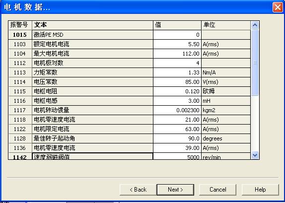

主题:如何在828D里面查找某一款西门子电机的详细参数
828D系统,我需要在里面查找一款1FE主轴电机的详细参数,如何查找。显示界面如图,请各位大侠帮忙,谢谢!

1FE1053-4WN11-xxxx
rated motor speed  7900 [1/min]
stall torque (100K)  20 [Nm]
SINAMICS
P0300  261   motortype
P0301  26119   motor code number SINAMICS
P0304  430  [V]  rated voltage
P0305  29  [A]  rated current (100K)
P0307  16,5  [kW]  rated power
P0311  7900  [1/min]  rated speed
P0312  20  [Nm]  rated torque (100K)
P0314  2   pole pair number
P0316  0,69  [Nm/A]  torque constant
P0317  45  [V/(1000 1/min)]  voltage constant
P0318  29  [A]  stall current (100K)
P0319  20  [Nm]  stall torque (100K)
P0320  31  [A]  short-circuit current
P0322  30000  [1/min]  max. permissible speed (mech.)
P0323  58  [A]  peak current
P0324  30000  [1/min]  max. permissible speed (electrical)
P0326  75  [%]  stall torque correction factor
P0327  110  [°]  optimum load angle
P0328  5  [mH]  reluctance torque constant
P0329  11,6  [A]  pole position identification current
P0335  2   cooling
P0338  58  [A]  limit current
P0341  0,0016  [kgm2]  moment of inertia
P0348  9000  [1/min]  start speed field weakening Vdc=600V
P0350  0,405  [Ohm]  stator resistance cold
P0356  4,2  [mH]  rotating field inductance
P0391  0  [A]  lower current limit adaptation
P0392  17,4  [A]  upper current limit adaptation
P0393  30  [%]  current controller adapation Pgain scalling upper
P0604  150  [°C]  overtemperature alarm threshold
P0605  160  [°C]  overtemperature fault threshold
P0611  0  [s]  i2t thermal time constant
P0612  0   configuration thermal motormodell
P0615  180  [°C]  overtemperature threshold motormodell
