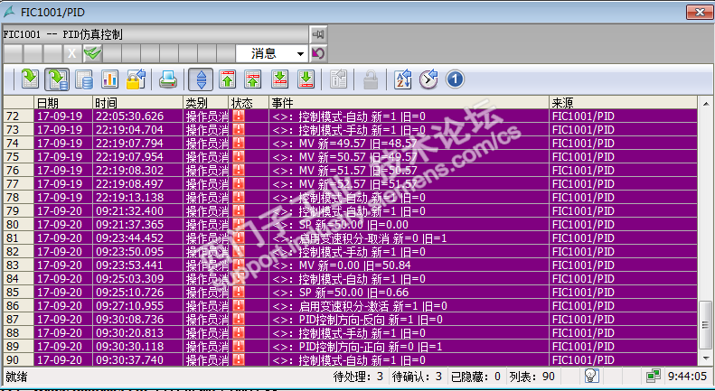

客户要求对上位机的操作进行记录,比如什么时候用户登录,什么时候操作了哪些按钮之类的。
这个应该怎么实现?

这是我项目中确认按钮的脚本,带操作记录的,你可以参考一下

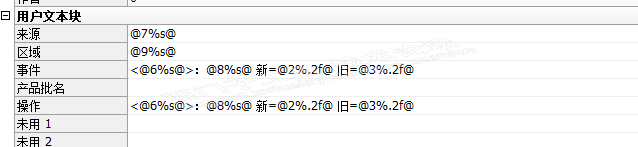

void SA_OperationMessage(TCHAR*lpszPictureName, int nMsgNr, long lValue[5], double dValue[5], char*lpszVal[5], BOOL BitORDouble)
BOOL bOK;
CMN_ERROR Error;
MSG_RTDATA_INSTANCECOMMENT_STRUCT MsgCreate;
      MsgCreate.dwMsgState = MSG_STATE_COME;
      MsgCreate.dwMsgNr = nMsgNr;
MsgCreate.wPValueUsed = 0x001F;
MsgCreate.wTextValueUsed = 0x03E0;
if(BitORDouble)
MsgCreate.dPValue[0] = dValue[0]; // @1%x@ ; x can be replaced by d,f
MsgCreate.dPValue[1] = dValue[1]; // @2%x@ ; x can be replaced by d,f
MsgCreate.dPValue[2] = dValue[2]; // @3%x@ ; x can be replaced by d,f
MsgCreate.dPValue[3] = dValue[3]; // @4%x@ ; x can be replaced by d,f
MsgCreate.dPValue[4] = dValue[4]; // @5%x@ ; x can be replaced by d,f
else
MsgCreate.dPValue[0] = lValue[0]; // @1%x@ ; x can be replaced by d,f
MsgCreate.dPValue[1] = lValue[1]; // @2%x@ ; x can be replaced by d,f
MsgCreate.dPValue[2] = lValue[2]; // @3%x@ ; x can be replaced by d,f
MsgCreate.dPValue[3] = lValue[3]; // @4%x@ ; x can be replaced by d,f
MsgCreate.dPValue[4] = lValue[4]; // @5%x@ ; x can be replaced by d,f
strcpy(MsgCreate.mtTextValue[5].szText, lpszVal[0]); // @6%s@
strcpy(MsgCreate.mtTextValue[6].szText, lpszVal[1]); // @7%s@
strcpy(MsgCreate.mtTextValue[7].szText, lpszVal[2]); // @8%s@
strcpy(MsgCreate.mtTextValue[8].szText, lpszVal[3]); // @9%s@
strcpy(MsgCreate.mtTextValue[9].szText, lpszVal[4]); // @10%s@
bOK= MSRTCreateMsgInstanceWithComment(0,&MsgCreate,&Error);
if (!bOK)
printf("MSRTCreateMsgInstanceWithComment szErrorText = %s
",Error.szErrorText );
在消息中建立一个消息
这是效果图
<>里面就是登录名称,你可以参考下
