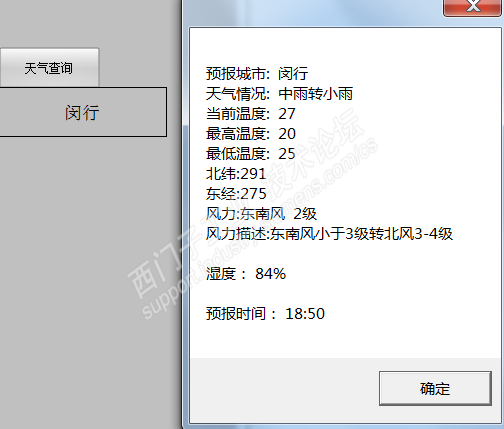

依照前辈的经验来优化的,http://www.ad.siemens.com.cn/club/bbs/post.aspx?a_id=1322113&b_id=5
依据查询的城市给天气接口地址分配相应的城市;
以下是城市查询的全局脚本(只写一点点):
查询数据严格依据http://flash.weather.com.cn/wmaps/xml/"&city&".xml"来查询
http://flash.weather.com.cn/wmaps/xml/"&provincename.value&".xml"'天气预来报接口地址

winc 画面;(输入城市名,再点击查询即可)
按钮查询VB脚本
Dim xDoc,xDocRoot,xNode
Dim pFile,i,strW
Dim provincename,pi,city
Set provincename = HMIRuntime.Tags("A.Province")
provincename.Read
Set city= HMIRuntime.Tags("A.city")
city.Read
pFile="http://flash.weather.com.cn/wmaps/xml/"&provincename.value&".xml"'天气预报接口地址
Set xDoc=CreateObject("Microsoft.XMLDOM")
xDoc.async=False
xDoc.load pFile
If  xDoc.parseError.errorCode = 0 Then
    Set xDocRoot =xDoc.documentElement
    i = 0
    Do While  i<xDocRoot.childNodes.length
           Set xNode = xDocRoot.childNodes.item(i)
      If  xNode.getAttribute("cityname")=city.value Then
              strW ="预报城市:  " & xNode.getAttribute("cityname") & vbCrlf & _
                    "天气情况:  " & xNode.getAttribute("stateDetailed") & vbCrlf & _
                    "当前温度:  " & xNode.getAttribute("temNow") & vbCrlf & _
                    "最高温度:  " & xNode.getAttribute("tem1") & vbCrlf & _
                    "最低温度:  " & xNode.getAttribute("tem2") & vbCrlf & _
                    "北纬:" & xNode.getAttribute("cityX") & vbCrlf & _
                    "东经:" & xNode.getAttribute("cityY") & vbCrlf & _
                    "风力:" & xNode.getAttribute("windDir") &"  "& xNode.getAttribute("windPower") & _
                    vbCrlf & "风力描述:" & xNode.getAttribute("windState") &  vbCrlf & _
                    vbCrlf & "湿度: " & xNode.getAttribute("humidity") & vbCrlf & _
                    vbCrlf & "预报时间: " & xNode.getAttribute("time")
             Exit Do
             Else
          i = i + 1
          End If
          Loop
    Else
            Msgbox"xml文件加载失败!"
            Msgbox"错误:"& char(13)& xDoc.parseError.reason
      End If
    Msgbox strW
    Set xNode=Nothing
    Set xDocRoot=Nothing
    Set xDoc=Nothing
