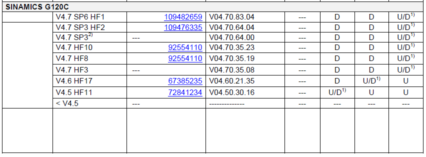

找到了  G120C 的 Firmware 版本文件
在这里
https://support.industry.siemens.com/cs/document/67364620/sinamics-g%3A-currently-available-firmware-releases-and-the-upgrade-downgrade-options-?dti=0&lc=en-WW
FAQ-02ET9YT6_G120_FWV-Up-grade_en.pdf (346,7 KB)
The SINAMICS G120 multicard contains the firmware releases for the following G120 products:
SINAMICS G120P (CU230P-2), firmware V4.7 HF8 (V04.70.35.19)
SINAMICS G120 (CU240B-2), firmware V4.7 HF8 (V04.70.35.19)
SINAMICS G120 (CU240E-2, CU250S-2), firmware V4.7 HF11 (V04.70.35.24)
SINAMICS G120D (CU240D-2, CU250D-2), firmware V4.7 HF11 (V04.70.35.24)
SINAMICS G120C, firmware V4.7 HF10 (V04.70.35.23)
SINAMICS G110M, firmware V4.7 HF11 (V04.70.35.24)
