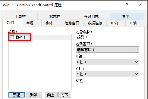

  1. 在画面中添加一个WinCC FuntionTrendControl 控件“TrendYX1”:
2. 添加趋势命名为“趋势1”:
A screenshot of a computer
AI-generated content may be incorrect.

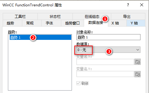

3. 在“数据连接”选项卡中选择“趋势1”的数据源的下拉列表中选择“0-无”:

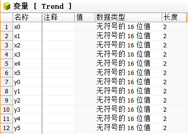

4. 在变量管理其中添加要绘制曲线的点X、Y的变量

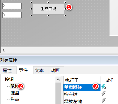

5、在画面中添加按钮,并在单击事件中添加VBS脚本:
A screenshot of a computer program

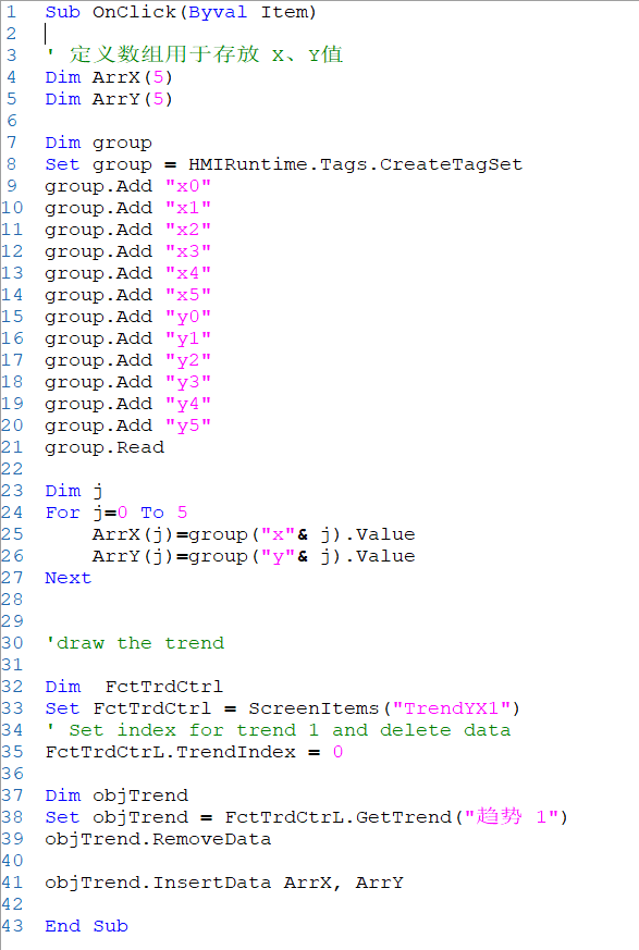

脚本内容:
' 定义数组用于存放 X、Y值
Dim ArrX(5)
Dim ArrY(5)
'读取所有变量"x0"、"x1"、"x2"、"x3"、"x4"、"x5"、"y0"、"y1"、"y2"、"y3"、"y4"、"y5"
Dim group
Set group = HMIRuntime.Tags.CreateTagSet
group.Add "x0"
group.Add "x1"
group.Add "x2"
group.Add "x3"
group.Add "x4"
group.Add "x5"
group.Add "y0"
group.Add "y1"
group.Add "y2"
group.Add "y3"
group.Add "y4"
group.Add "y5"
group.Read
'生成趋势所需的数据存入数组ArrX和ArrY
Dim j
For j=0 To 5
ArrX(j)=group("x"& j).Value
ArrY(j)=group("y"& j).Value
Next
'绘制曲线
Dim FctTrdCtrl
Set FctTrdCtrl = ScreenItems("TrendYX1")
'选中索引编号为0的曲线即“趋势1”
FctTrdCtrL.TrendIndex = 0
'清空所有数据
Dim objTrend
Set objTrend = FctTrdCtrL.GetTrend("趋势 1")
objTrend.RemoveData
'插入数据生成趋势
objTrend.InsertData ArrX, ArrY

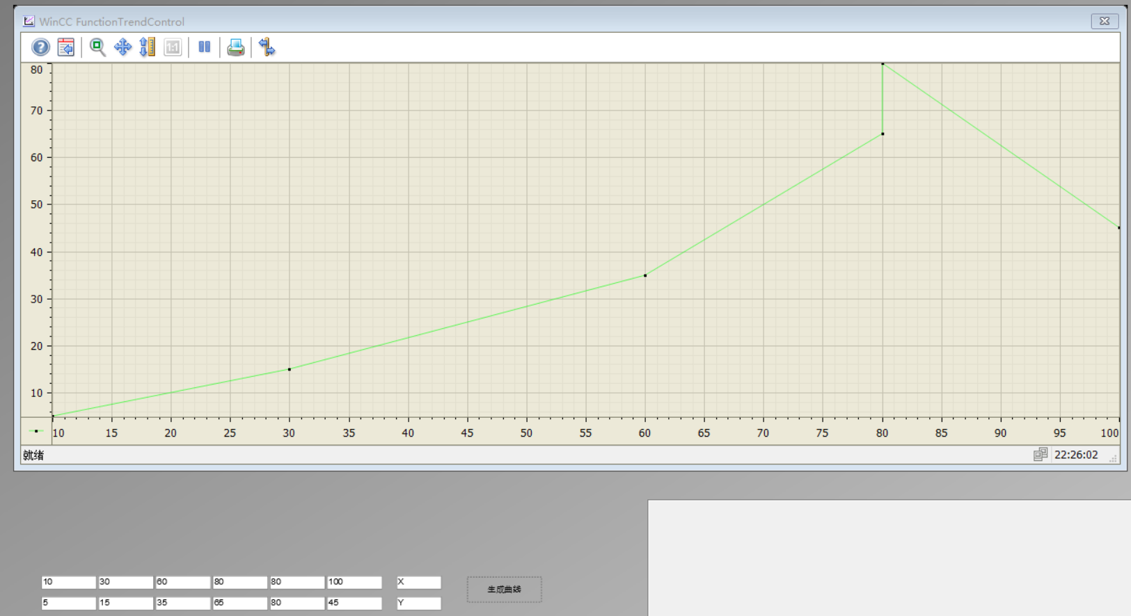

6. 项目运行后绘制的6个X和Y 的值对的曲线如下图所示:
A screen shot of a graph
