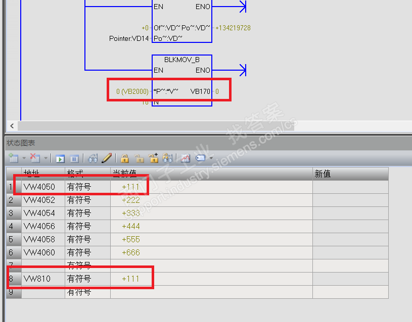

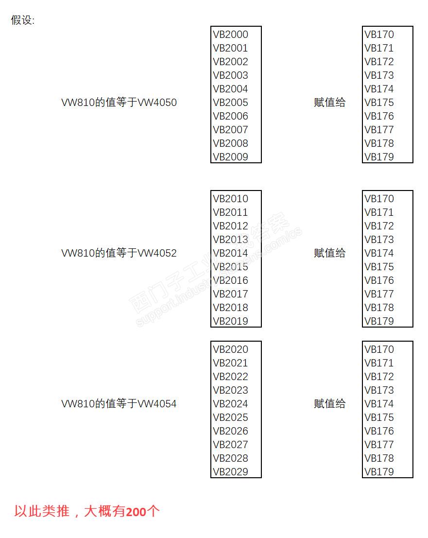

Network 1
LD SM0.0
MOVD 0, VD0
Network 2
LD SM0.0
FOR VW4, 0, 199
Network 3
LD SM0.0
LPS
MOVD &VB4050, AC1
AENO
MOVD VD0, VD10
AENO
+D AC1, VD10
AENO
+D 2, VD0
LPP
AW= VW810, *VD10
MOVW VW4, VW6
Network 4
NEXT
Network 5
LD SM0.0
MOVD &VB2000, VD14
ITD VW6, VD18
MOVD +10, VD22
*D VD18, VD22
+D VD22, VD14
BMB *VD14, VB170, 10
