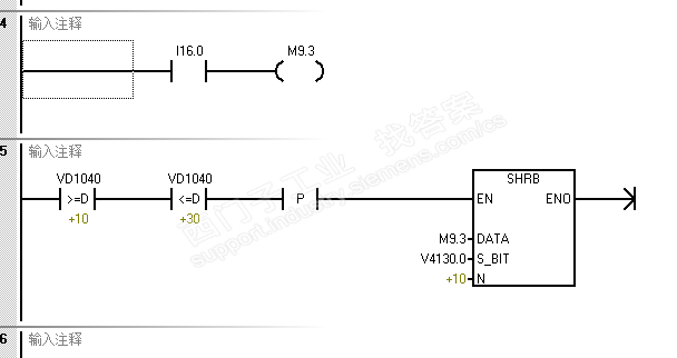

但是这个1200无法使用必须1500

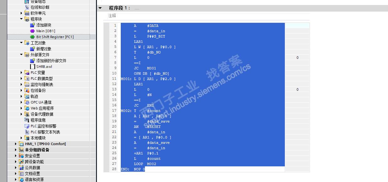

你看看你能否自己根据官网的STL语言编写个SCL语言的类似程序
A #DATA
= #data_in
L P##S_BIT
LAR1
L W [ AR1 , P#0.0 ]
T #db_NO
L 0
==I
JC M001
OPN DB [ #db_NO]
M001: L D [ AR1 , P#2.0 ]
LAR1
L 0
L #N
==I
JC END
M002: T #count
A [ AR1 , P#0.0 ]
= #data_save
AN #RESET
A #data_in
= [ AR1 , P#0.0 ]
A #data_save
= #data_in
+AR1 P#0.1
L #count
LOOP M002
END: NOP 0
