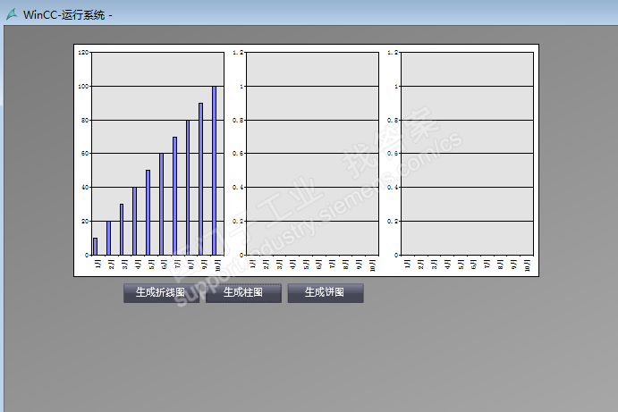

Set Chart =ScreenItems("控件1")
Set c =Chart.Constants
Chart.Charts.Add
Chart.Charts.Item(0).SeriesCollection.Add
For i =1 To 10
xValue(i) =i&"月"
yValue(i) =i*10
Next
'数据绑定X轴
Chart.Charts.Item(0).SetData c.chDimCategories,c.chDataLiteral,xValue
'数据绑定Y轴
Chart.Charts.Item(0).SeriesCollection.Item(0).SetData c.chDimValues,c.chDataLiteral,yValue
End Sub
