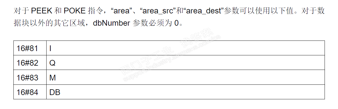

POKE(area := 16#82,
dbNumber := 0,
byteOffset := 511,
value := #Value);
POKE(area := 16#82,
dbNumber := 0,
byteOffset := 1016,
value := #Value_01_DW);
POKE(area := 16#82,
dbNumber := 0,
byteOffset := 1020,
value := #Value_02_DW);
FOR #ForCounter := 0 TO 63 DO
#Value:=PEEK(area := 16#1,
dbNumber := 0,
byteOffset := #ForCounter);
POKE(area := 16#81,
dbNumber := 0,
byteOffset := #ForCounter,
value := #Value);
END_FOR;
#Value := PEEK(area := 16#1,
dbNumber := 0,
byteOffset := 512);
POKE(area := 16#82,
dbNumber := 0,
byteOffset := 512,
value := #Value);
CPU 临时错误:FC 9000 I/O 读访问出错(I 地址 512)
将影响 OB 1 的执行
