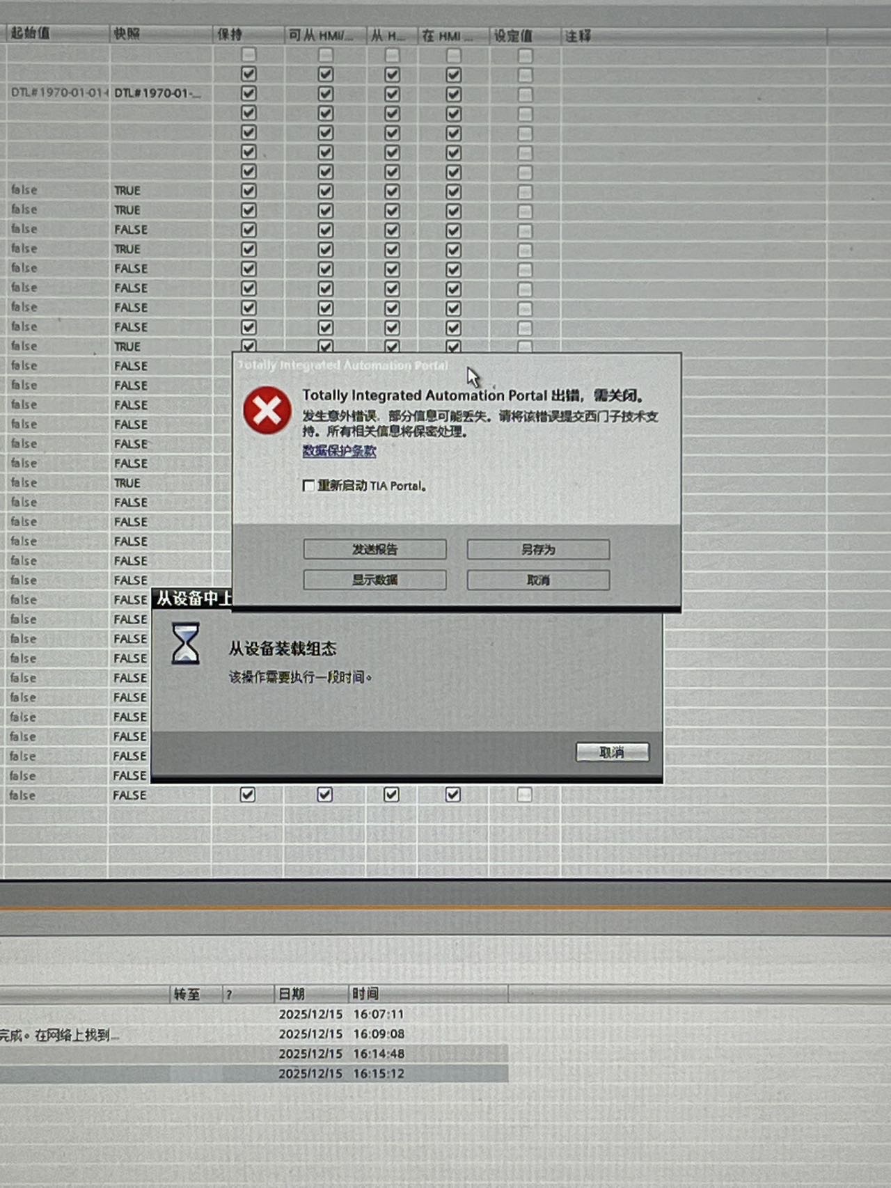

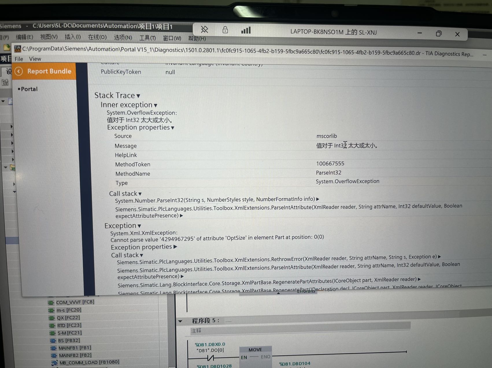

TIA Portal 在编译 PLC 时崩溃:(参考这个链接做法)
https://support.industry.siemens.com/cs/cn/zh/view/109971630
STEP7 Basic/Professional and WinCC V15.1 更新包:
https://support.industry.siemens.com/cs/us/en/view/109763890
