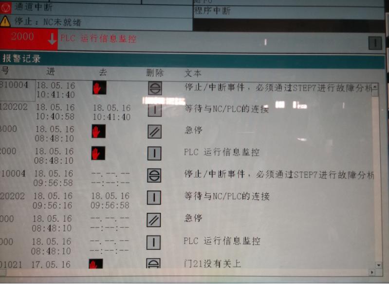

下面为部分诊断记录:*****更多的记录我已将Diagnose-2016-5-18.TXT伪装成了JPG格式上传,烦下载后修改后缀成TXT查看,谢谢!
Diagnostic buffer of module PLC 317-2DP
Order No./ Description Component Version
6FC5 317-2AJ10-1AB0 Hardware 2218
20.71.30 06.02.2006 Firmware V 2.1.8
Rack: 0
Slot: 2
Event 1 of 100: Event ID 16# 38C4
Distributed I/Os: station return
Address of the affected DP slave: station number: 7
DP master system ID: 1
Log. base address of the DP slave: Input address: 8185
Log. base address of the DP master: 8191
Requested OB: Rack failure OB (OB86)
OB not found, or disabled, or cannot be started in the current operating mode
External error, Outgoing event
08:49:47:713 am 05/18/16
Event 2 of 100: Event ID 16# 3842
Module OK
Module type: Distributed I/O
Input address: 8185
User information available
Diagnostic interrupt from substitute
Requested OB: Diagnostic interrupt OB (OB82)
08:49:47:664 am 05/18/16
Event 3 of 100: Event ID 16# 4563
STOP caused by I/O access error (OB not loaded or not possible, or no FRB)
Breakpoint in user program: Cyclic program (OB1)
Priority class: 1
FC number: 111
Module address: 64
Previous operating mode: RUN
Requested operating mode: STOP (internal)
Internal error, Incoming event
08:48:10:928 am 05/18/16
楼主的问题我在利用西门子840D系统改造数控外圆磨床时遇到过,按照以下四步骤解决:
1.多看少动,全清NC、PLC复位后即可进行数据回装,注意,NC与plc数据的格式均为*.arc,可以先装NC再装plc,如果在安装过程中出现询问,不要管,只要按下屏幕上的软键”YES“,确认即可。如仍然无法正常安装,继续下一步,
2.检查MMC单元的连接是否正常可靠,你可以打开操作箱单元,检查MMC单元的各个电缆如MPI、Profibus-dp的连接是否可靠,注意各个插座上的接线做好标记,以防插错,
3.检查NCK备份电池,重新更换后再试机,
4.如以上未凑效,更换NCU-BOX单元,再试机, \\这个是重点检查项目,因为根据现象:
不断启动、热复位、拔插NCU主板;
5.如果故障未变,更换NCU单元,再试机,
一般来说,按照以上方法,即可快速确定故障原因,祝好运!
