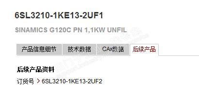

1、6SL3210-1KE13-2UF1:SINAMICS G120C RATED POWER 1,1KW WITH 150% OVERLOAD FOR 3 SEC 3AC380-480V +10/-20% 47-63HZ UNFILTERED I/O-INTERFACE: 6DI, 2DO,1AI,1AO SAFE TORQUE OFF INTEGRATED FIELDBUS: PROFINET-PN PROTECTION: IP20/ UL OPEN TYPE SIZE: FSA 196X73X203(HXWXD) EXTERNAL 24V
https://support.industry.siemens.com/cs/pd/200777?pdti=pi&dl=zh&lc=zh-WW
2、6SL3210-1KE13-2UF2:SINAMICS G120C RATED POWER 1,1KW WITH 150% OVERLOAD FOR 3 SEC 3AC380-480V +10/-20% 47-63HZ UNFILTERED I/O-INTERFACE: 6DI, 2DO,1AI,1AO SAFE TORQUE OFF INTEGRATED FIELDBUS: PROFINET-PN PROTECTION: IP20/ UL OPEN TYPE SIZE: FSA 196X73X225,4(HXWXD) EXTERNAL 24V
https://support.industry.siemens.com/cs/pd/627816?pdti=pi&dl=zh&lc=zh-CN
3、6SL3210-1KE13-2UF1 与6SL3210-1KE13-2UF2:两者除了外形尺寸深度或厚度略差点,没啥区别,其中2UF2为2UF1的后续产品。
