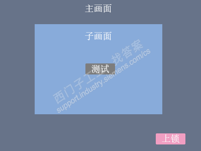

Dim objButton
Set objButton = ScreenItems("PictureWindow1").Screen.ScreenItems("Button_test")
objButton.Enabled = False
