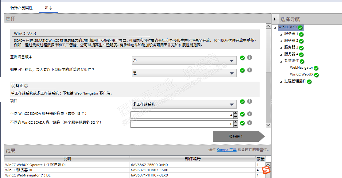

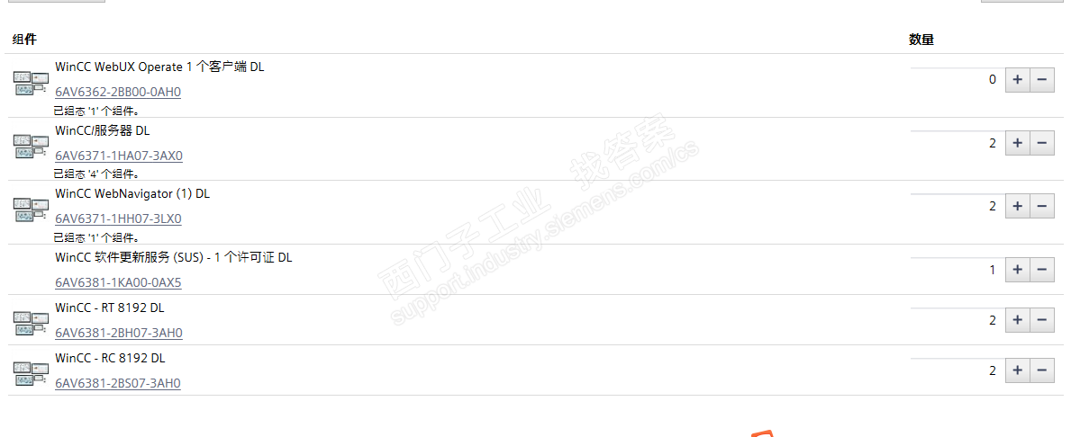

5、WINCC V7.3 订货号在链接最下面
https://support.industry.siemens.com/cs/document/97493192
