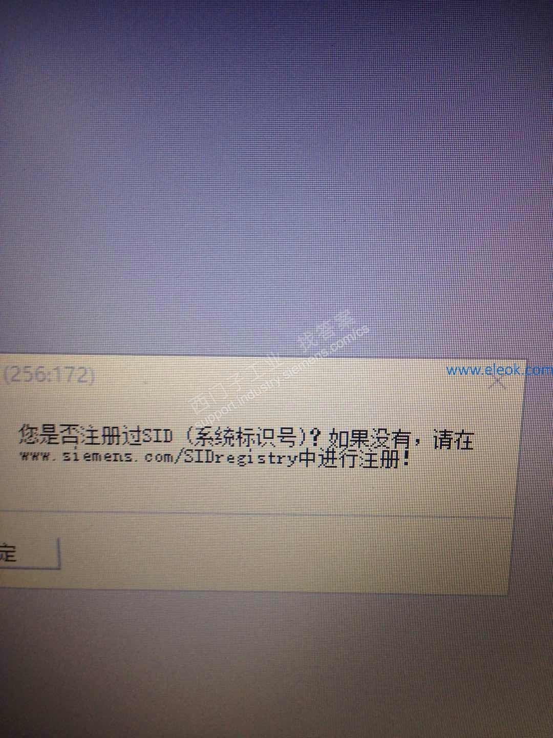

1、这个是PCS7 V9.0才有的,一种新的服务理念,为了更快更好的服务客户。如果不希望每次打开软件时都弹出这个提示可以去 www.siemens.com/SIDregistry这个网站上免费注册,然后在项目属性中添加该SID。
2、不注册也不影响使用。
在如下手册中有关于SID(88页)的介绍:
https://support.industry.siemens.com/cs/us/en/view/109756485
其中的描述如下:
A new service concept was introduced with SIMATIC PCS 7 V9.0, which is based on a
system-specific system identification number – the System ID (SID).
The System ID is generated once when you register your new system for free at
www.siemens.com/SIDregistry (www.siemens.com/SIDregistry) and is stored centrally at
Siemens Technical Support. It then serves as the unique identification of your PCS 7 system over its entire life cycle.
The System ID is assigned to your PCS 7 multiproject by entering the System ID in the
properties of the multiproject in SIMATIC Manager. The System ID entered there is also an
integral component of the inventory data that you read out with the SIMATIC Management
Console and can be sent to Siemens Technical Support via a Support Request.
Technical Support adds the transmitted inventory data and all the requests you make over
the system''s life cycle to your basic data. Registering your system offers you the following
advantages:
● Faster and more targeted support saves you time and may shorten or prevent system
stoppages.
● Holistic and fast error correction based on the current system configuration
● Lasting troubleshooting through documentation of all previous requests
