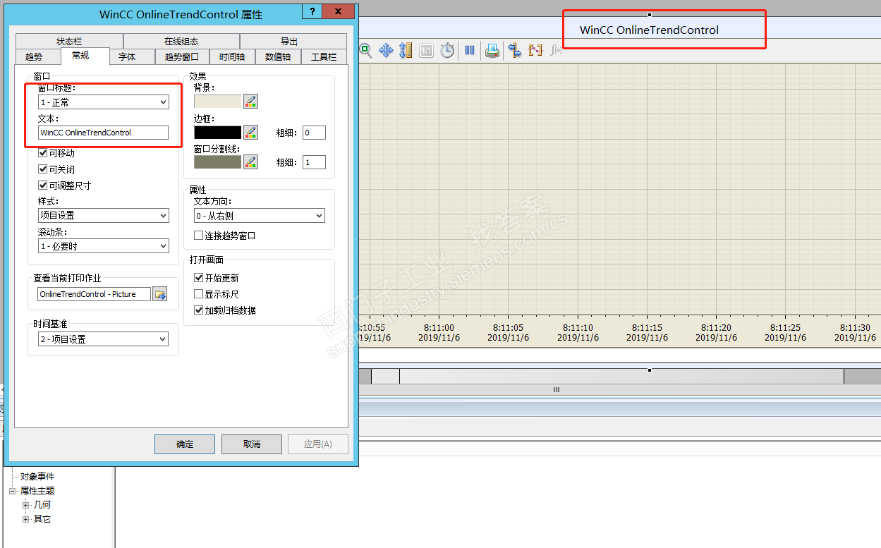

Dim obj
Set obj = ScreenItems("趋势控件名称")
obj.Caption = "新标题"
