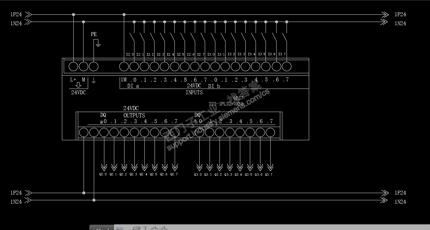

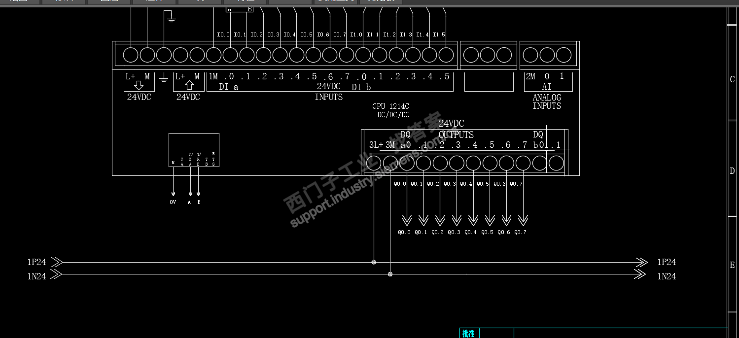

Q点输出跟3L+端子的接电正负一致,3L+接1P24即24Vdc+,那么Q点输出为24Vdc+。3M端子接1N24,即24Vdc-。
S7-1200接线图资料:
http://www.ad.siemens.com.cn/productportal/prods/s7-1200_plc_easy_plus/06-IO/01-CPU/01-wiring.html
S7-1200数字量输入输出接线:
http://www.ad.siemens.com.cn/productportal/prods/s7-1200_plc_easy_plus/06-IO/02-DIDO/01-wiring.html
