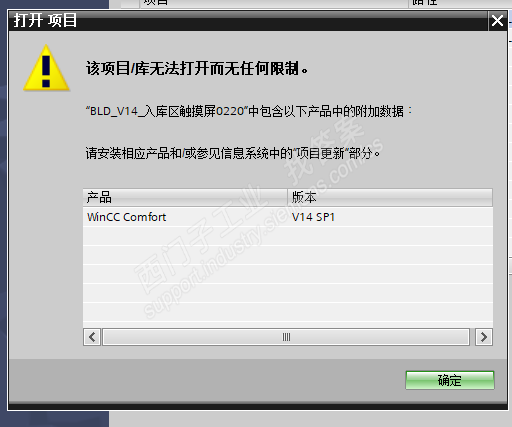

1、应该是你没有安装wincc comfort v14 sp1 !
2、在菜单栏“帮助”里面查看已安装的软件,看看是否有wincc comfort v14 sp1 !
3、wincc comfort v14 sp1 软件下载:
https://support.industry.siemens.com/cs/document/109746074/servicepack-1-for-simatic-wincc-v14-engineering-(-incl-trial-)-?dti=0&lc=en-CN
