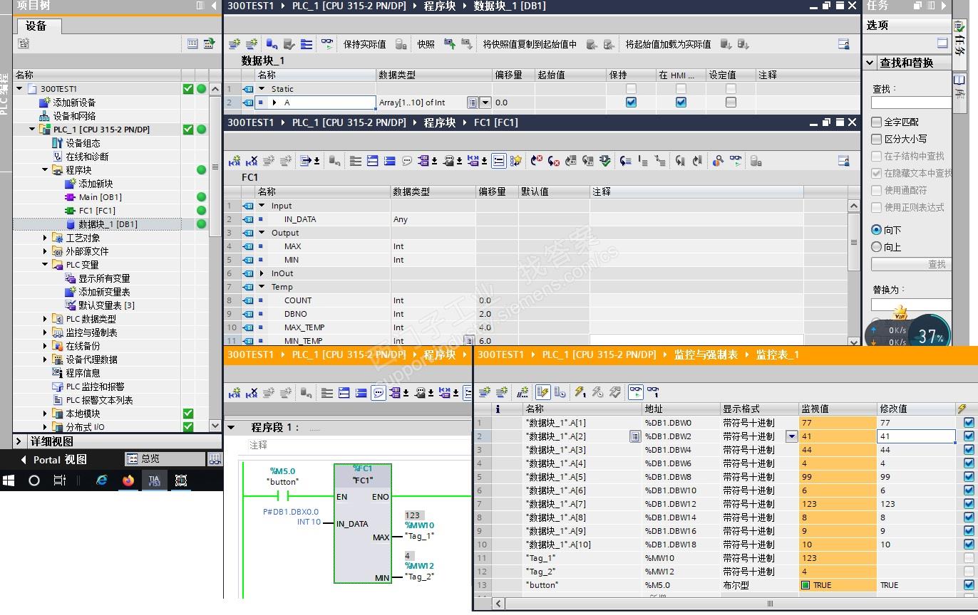

DB 数据块定义、FC 接口定义、OB1 中的调用方式,以及仿真如图
FC1 中的代码,与图中的接口定义必须相符,代码如下
L P##IN_DATA
LAR1
L W [ AR1 , P#4.0 ]
T #DBNO
L W [ AR1 , P#2.0 ]
T #COUNT
OPN DB [ #DBNO]
L D [ AR1 , P#6.0 ]
LAR1
L DBW [ AR1 , P#0.0 ]
T #MAX_TEMP
T #MIN_TEMP
L #COUNT
L 1
-I
NEXT: T #COUNT
L DBW [ AR1 , P#2.0 ]
L #MAX_TEMP
>I
JCN m1
T #MAX_TEMP
m1: L DBW [ AR1 , P#2.0 ]
L #MIN_TEMP
<I
JCN m2
T #MIN_TEMP
m2: TAR1
L P#2.0
+D
LAR1
L #COUNT
LOOP NEXT
L #MAX_TEMP
T #MAX
L #MIN_TEMP
T #MIN
