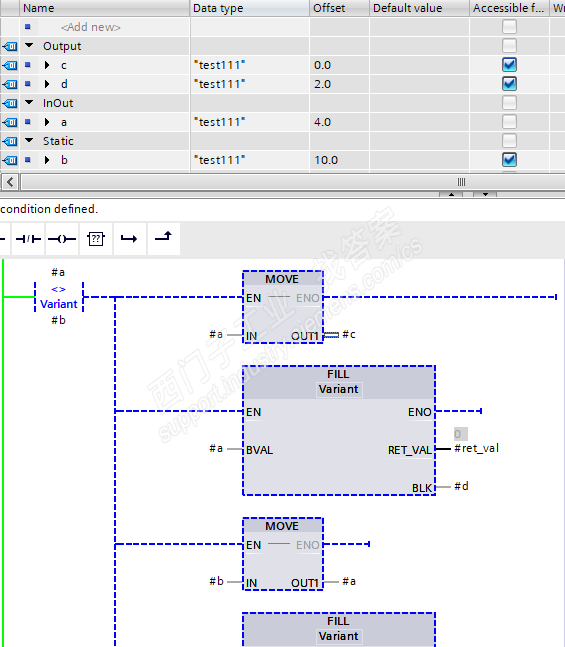

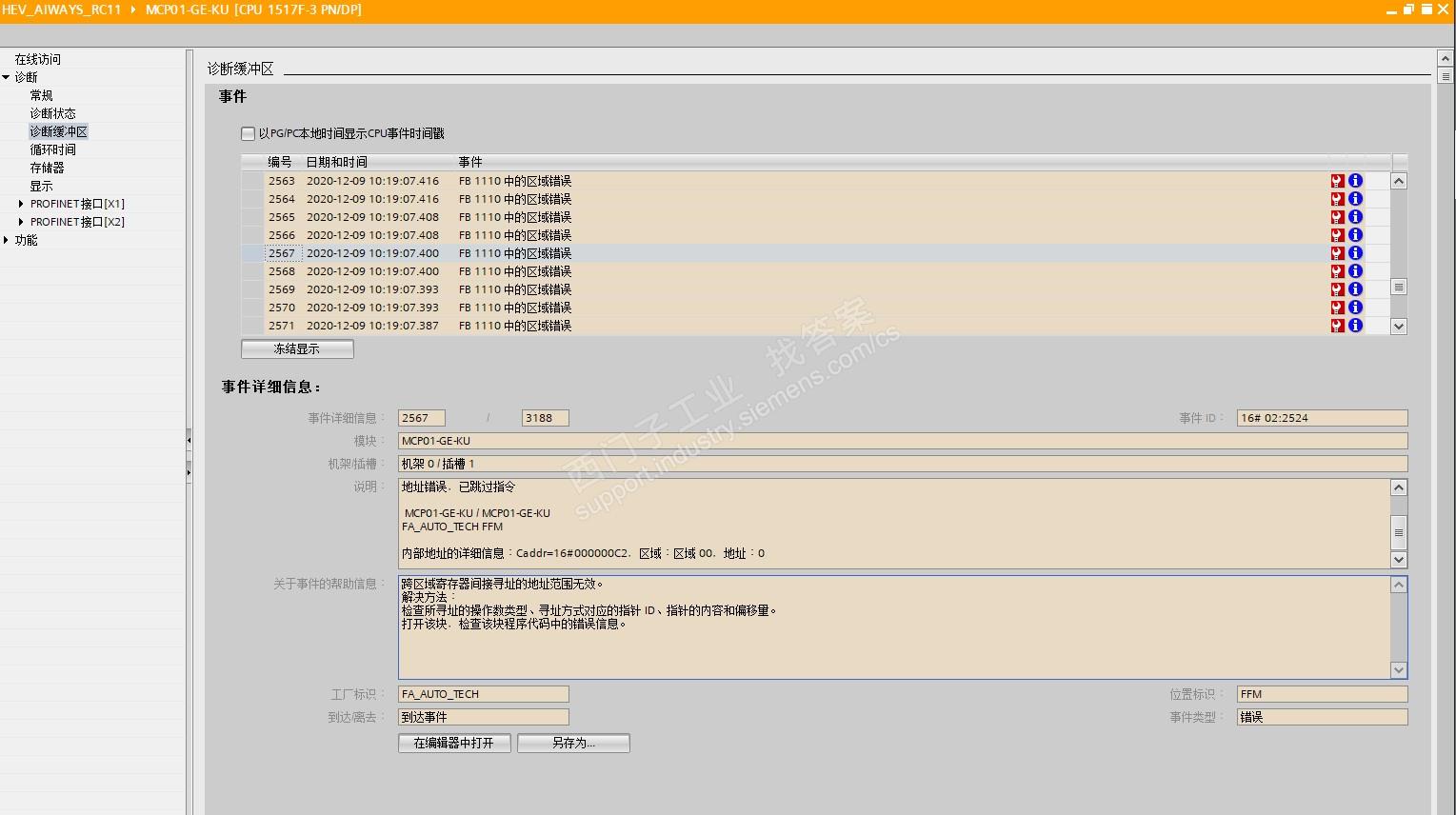

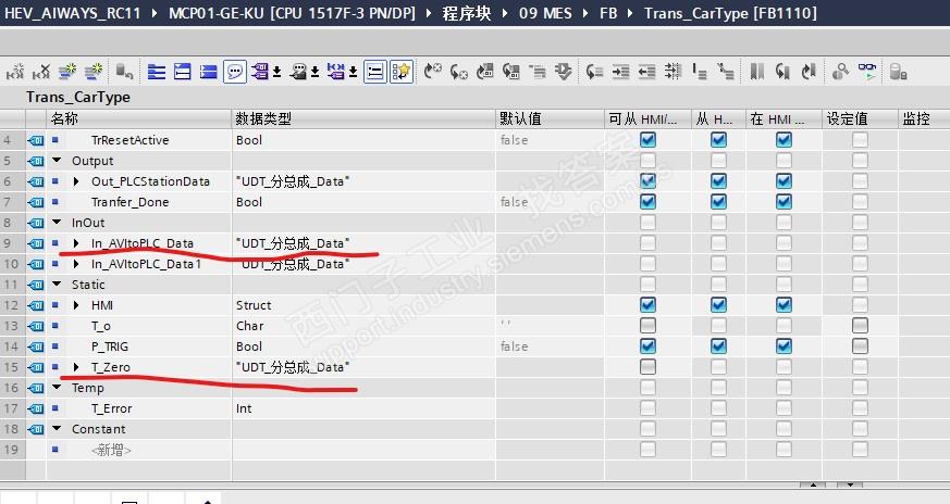

我测试了一下,并没有什么问题,你这个唯一的问题是我没有看到FB块的绝对地址,关于FILL,帮助里是这么描述的:
The tags of the instruction can only be used within memory areas in which the "Optimized block access" attribute is not activated. This applies to data blocks (DBs), organization blocks (OBs), functions (FCs), bit memory (M), inputs (I), and outputs (Q).
If a tag of the instruction has been declared with the retentivity setting "Set in IDB", however, you can use this tag in memory areas "with optimized block access".
这个FILL的管脚要么是有绝对地址的,要么是设置为“Set in IDB”的,但是你这里有用到INOUT,所以只能是非优化的FB才可以,但是我并没看到;另外其实你可以用MOVE来传送,不用FILL,因为我看到你的数据类型是同一个,并不是要用到FILL的功能,只是简单的覆盖
