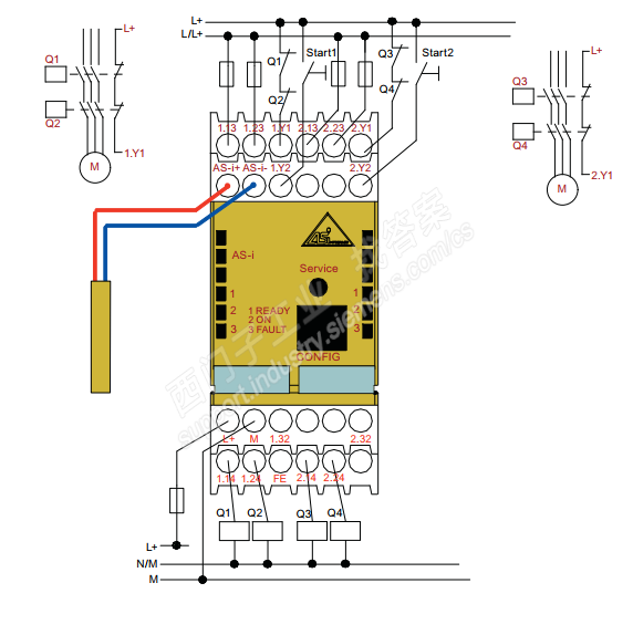

1、 输出的1.14和1.24的输出受什么控制? 是来自ASI总线的信号控制的?
2、1.32什么条件下输出?
a侠手册写的是1.14和1.24是1.13和1.23加1.Y1条件满足后的输出,1.32应该是应该反馈给plc信号
https://support.industry.siemens.com/cs/document/24509484/function-manual-asisafe-circuits-for-safety-technology-with-as-interface-safety-monitor-and-dp-as-i-f-link?dti=0&lc=en-WW
https://cache.industry.siemens.com/dl/files/172/24432172/att_71520/v1/ASiSafetyMon_en_2008-09_Safety_Monitor_Operating_Instructions_333155702DS02.pdf
