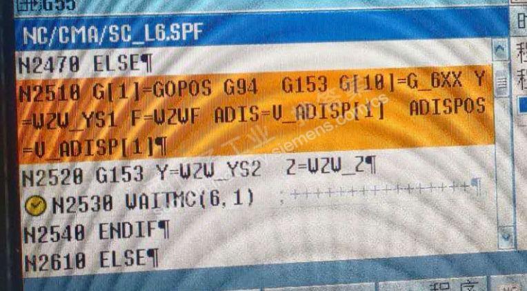

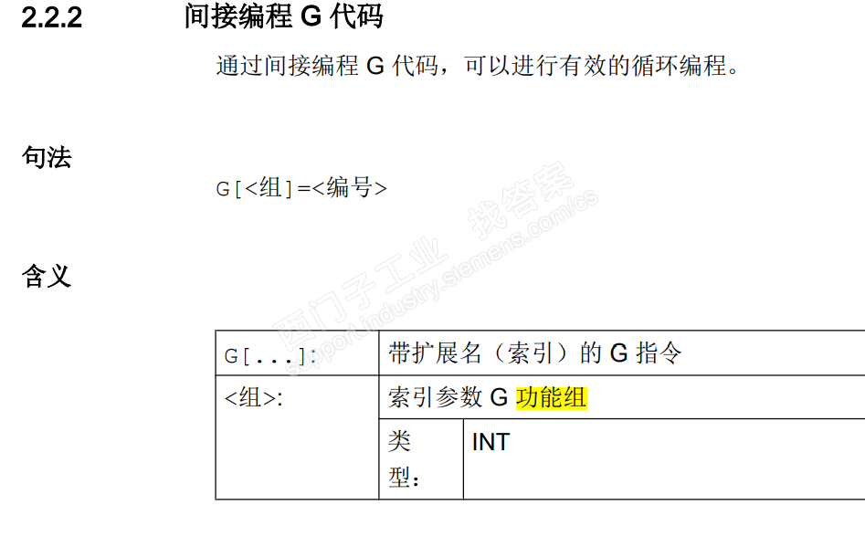

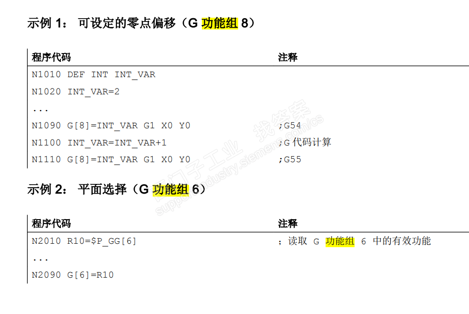

a侠在nc编程手册中有间接G功能编程说明,G功能组编程有1-62个组,就以手册上面说的为例
N1010 DEF INT INT_VAR
N1020 INT_VAR=2
N1090 G[8]=INT_VAR G1 X0 Y0 ;G54
N1100 INT_VAR=INT_VAR+1 ;G 代码计算
N1110 G[8]=INT_VAR G1 X0 Y0 ;G55

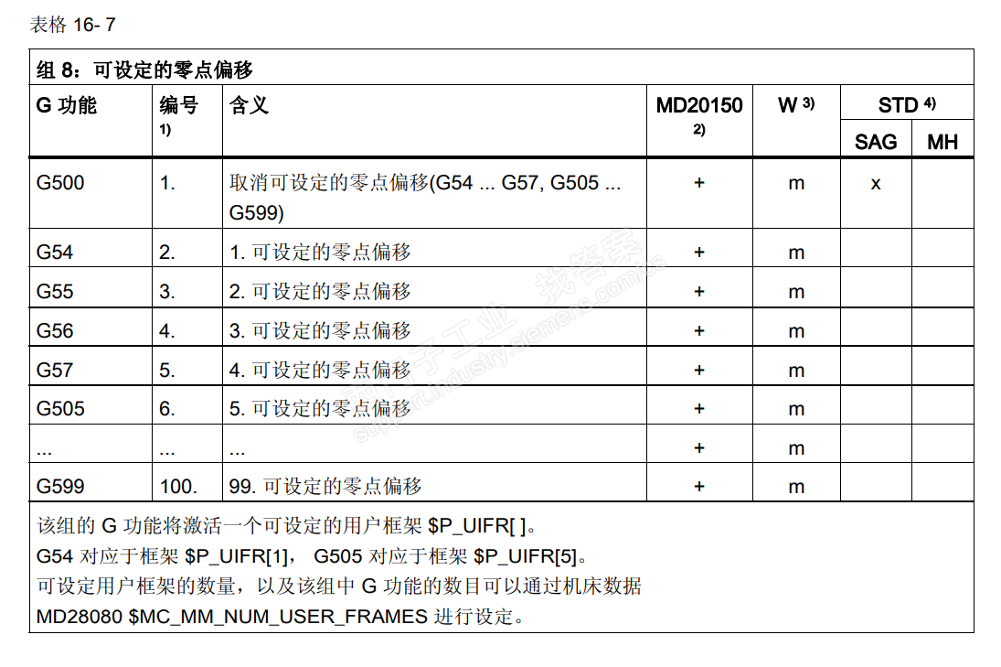

G[8]是G功能组8,INT_VAR=2是编号2
所以G[8]=INT_VAR指向G54
