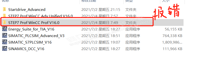

这个faq里有说明。这个就是触摸屏的组态工具。不使用触摸屏和上位机的情况下,可以不安装。

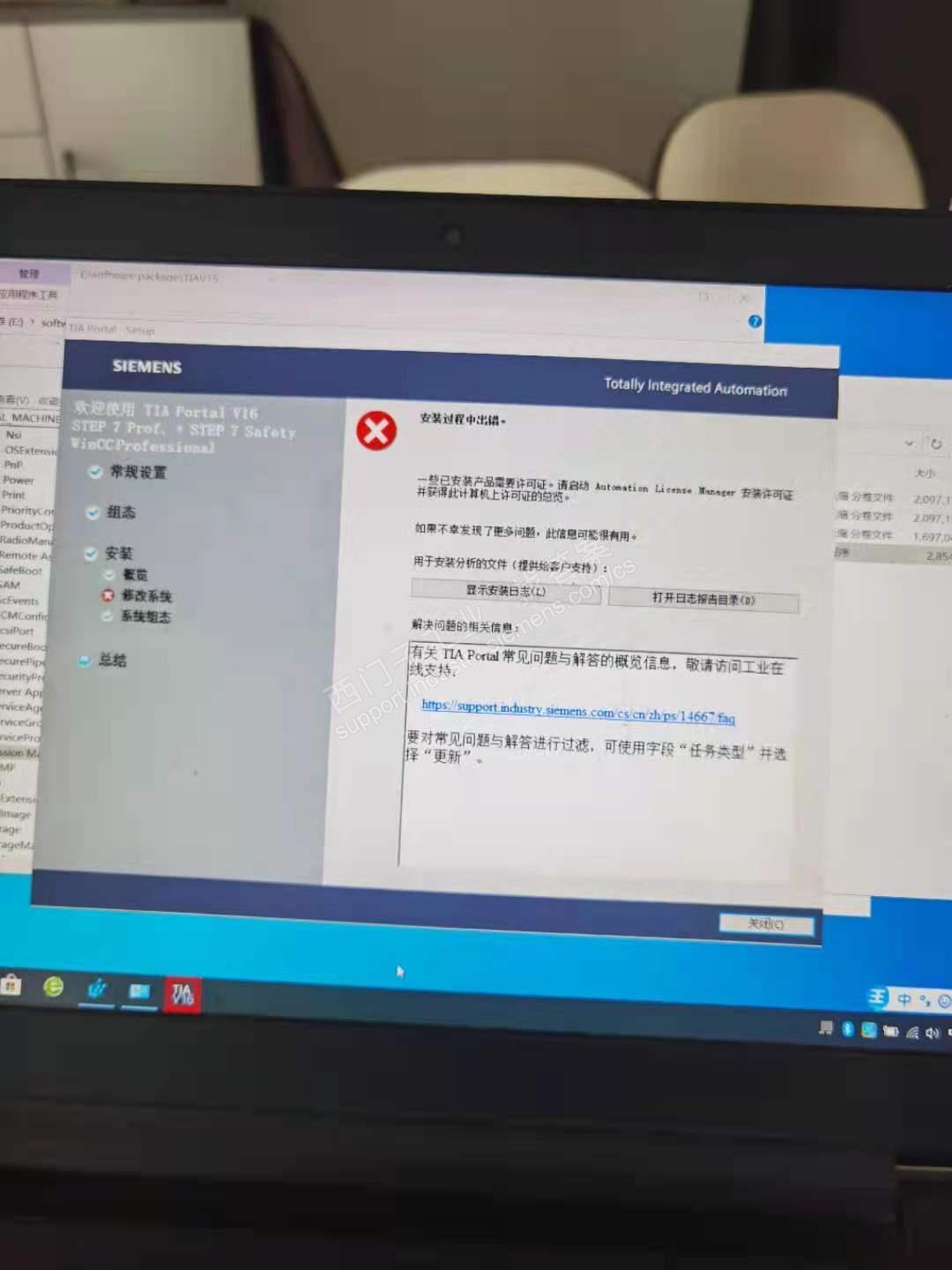

你的电脑以前安装过tia,然后卸载了,然后再安装tia v16就可能会出这个问题
https://support.industry.siemens.com/cs/document/109795924/why-does-setup-of-tia-portal-versions-v13-sp2-v14-sp1-or-v15-1-in-windows-10-fail-after-installing-the-update-20h2-?dti=0&lc=en-WW
Solution
The cause of the error message can be one of the following among others:
An outdated version of the Microsoft Edge browser
A current version of the Microsoft Edge browser is required for a successful setup.
To update, follow the procedure given in Entry 109749283 in the section entitled "Note on "20H2" and SQL Server".
No enablement of .NET 3.5
For a successful setup, .NET 3.5 must be enabled.
To enable .NET 3.5, follow the procedure described in Entry 109773589.
如果按照上边的方案解决不了,就重装系统吧。注意系统版本。尽量用win10专业版/企业版等,版本号1809/1903/1909/20H2等
