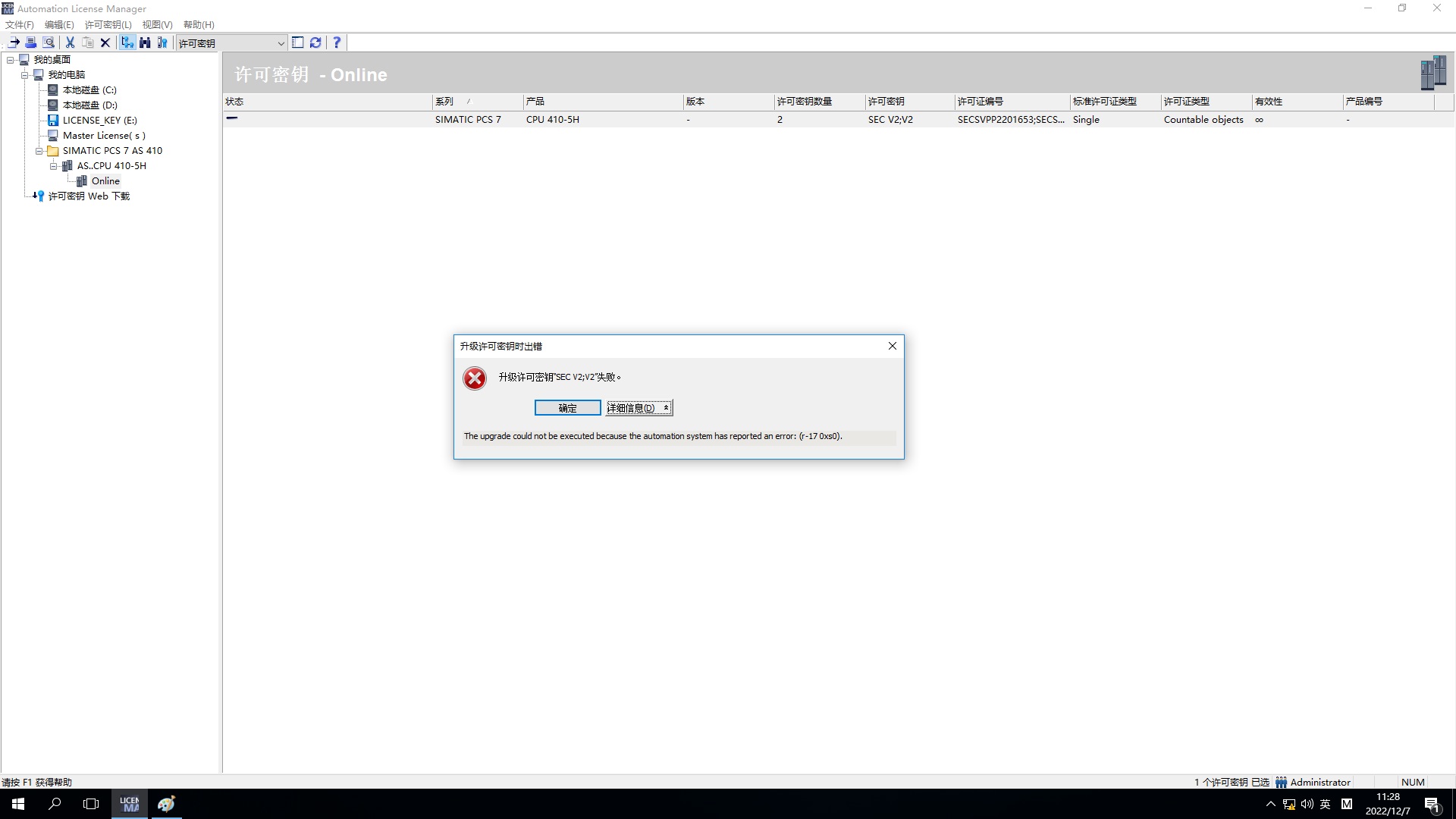

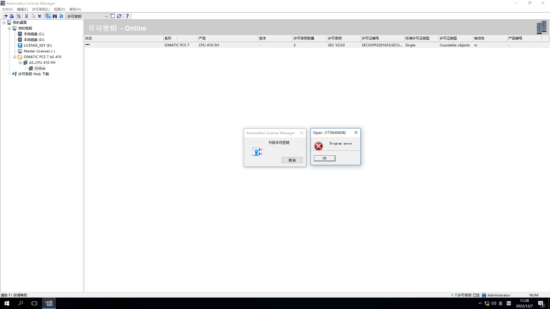

No program was loaded on the CPU and stopped due to non-existent OBs. However,
as a prerequisite for the upgrade, HW config and program must be loaded,
see Process Automation with the Controller SIMATIC PCS 7 CPU 410-5H
没有下载程序导致的
