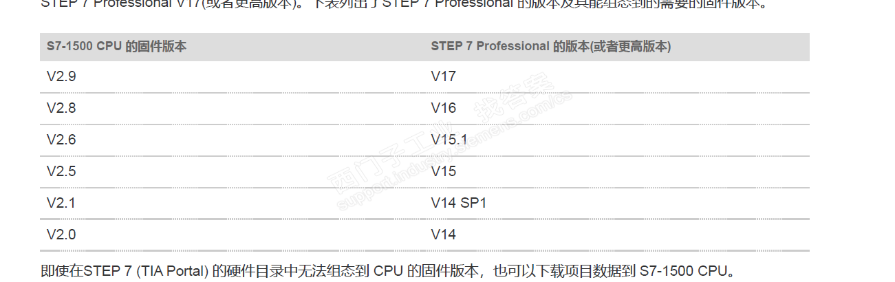

补充回答看图
https://www.ad.siemens.com.cn/productportal/prods/1500published/CPU/CPU_7.1/CPU_7.1.html#_Toc2
https://support.industry.siemens.com/cs/cn/zh/view/109744163
