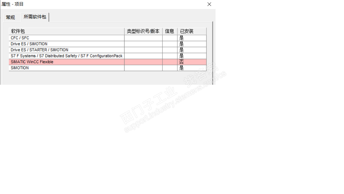

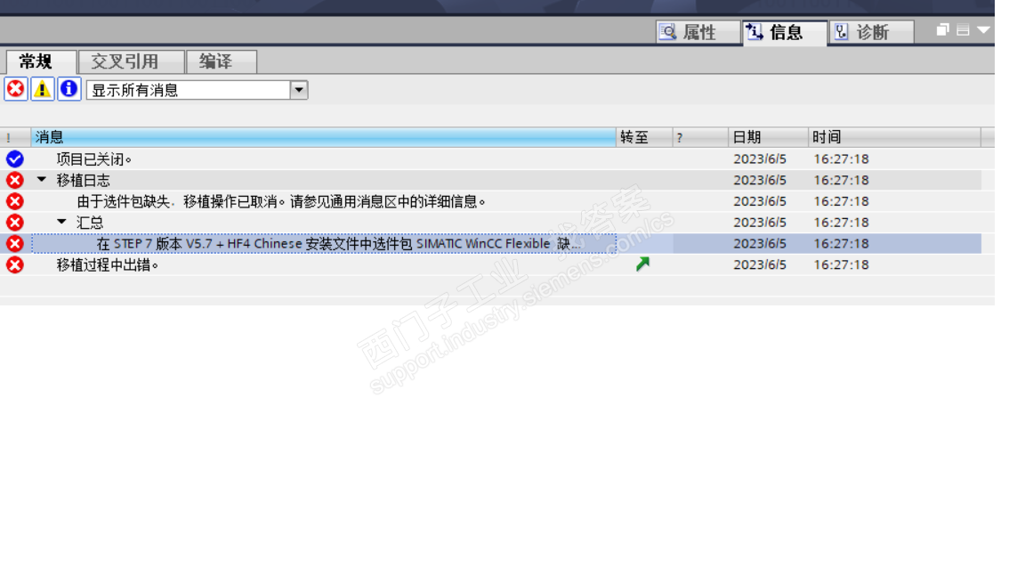

是不是STEP7中相关的Wincc flexible 集成没有安装,或者解除集成?https://www.ad.siemens.com.cn/productportal/prods/hmi/comfortpanel/q6_migration/faq3_migration_error.html
