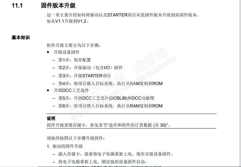

《SINAMICS DCM 直流整流器, 操作说明, 固件版本 V1.5》---如图章节,用的是STARTER
https://support.industry.siemens.com/cs/document/109763558
Firmware for the SINAMICS DCM / SINAMICS DCM Control Module and the associated SSPs for STARTER - News
https://support.industry.siemens.com/cs/document/44029688
