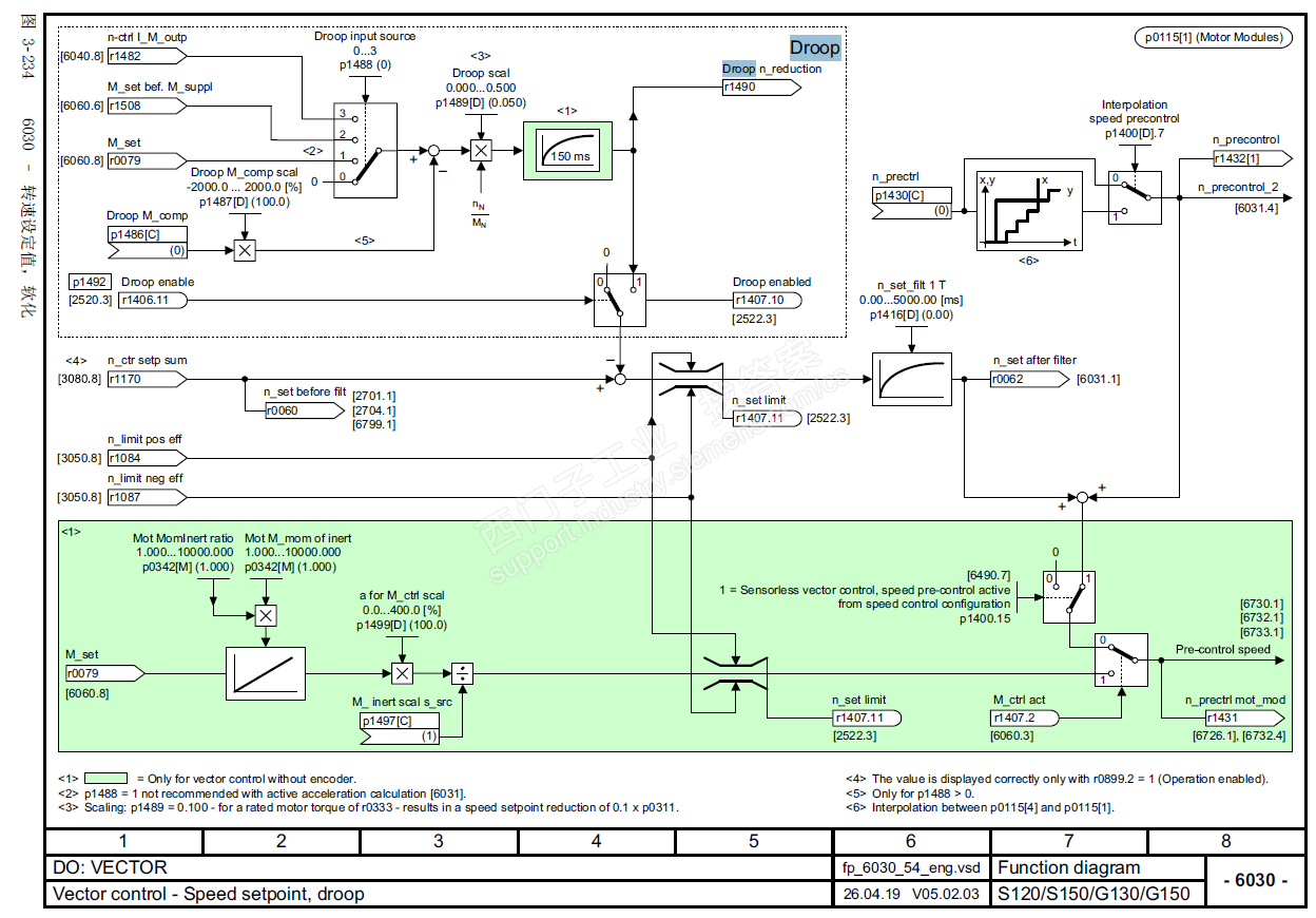

下垂控制,也就droop软化功能,可以在负载转矩增加时速度设定值按比例降低,通过参数P1492使能。
参考:
MICROMASTER 4 (MM4), SINAMICS G120 (CU2x0x): How is droop control used in load sharing applications?
https://support.industry.siemens.com/cs/cn/en/view/12745006
https://support.industry.siemens.com/cs/cn/zh/view/12745006
