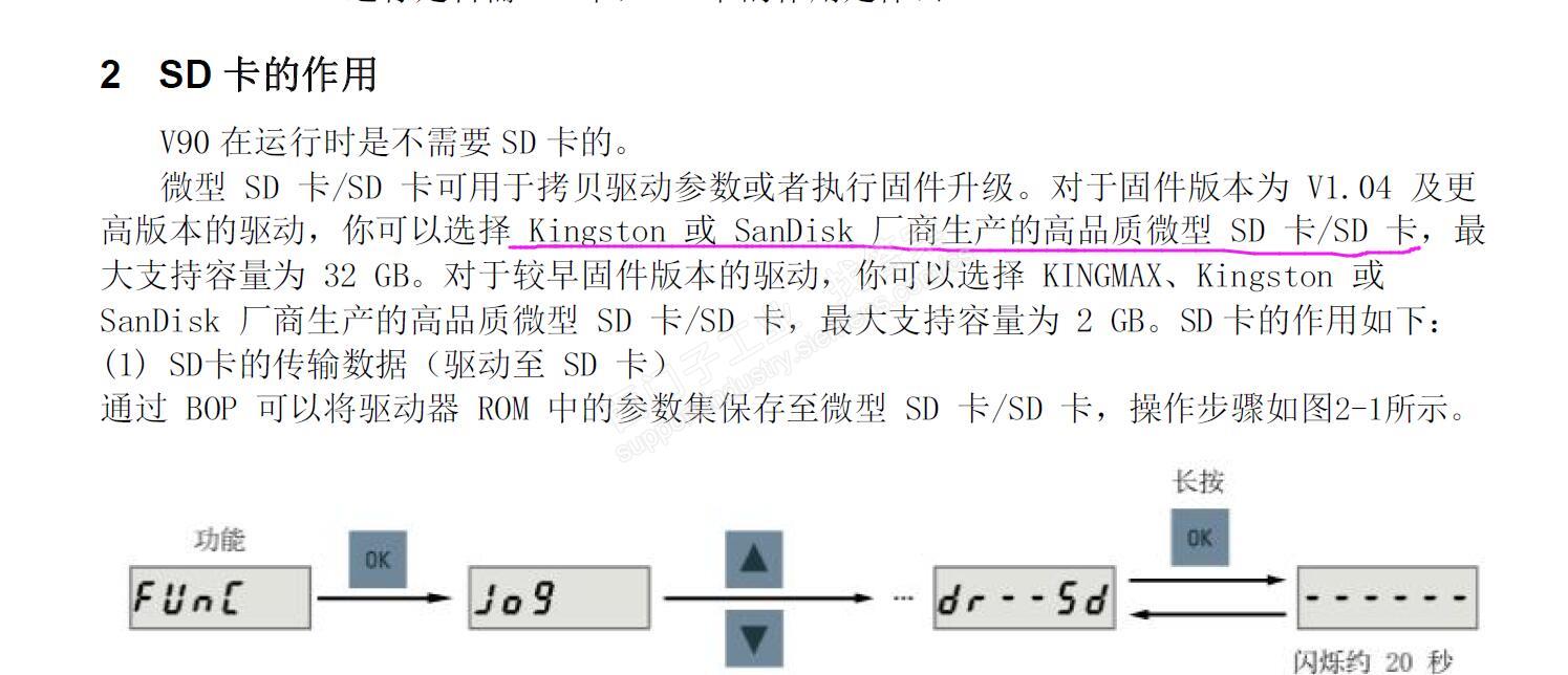

不是
https://www.ad.siemens.com.cn/download/documentdetail_9055.html
https://strcsstatic.blob.core.chinacloudapi.cn/downloadcenterproduction/Upload/DocFiles/20167/9055/tb/V90SDCard.pdf
