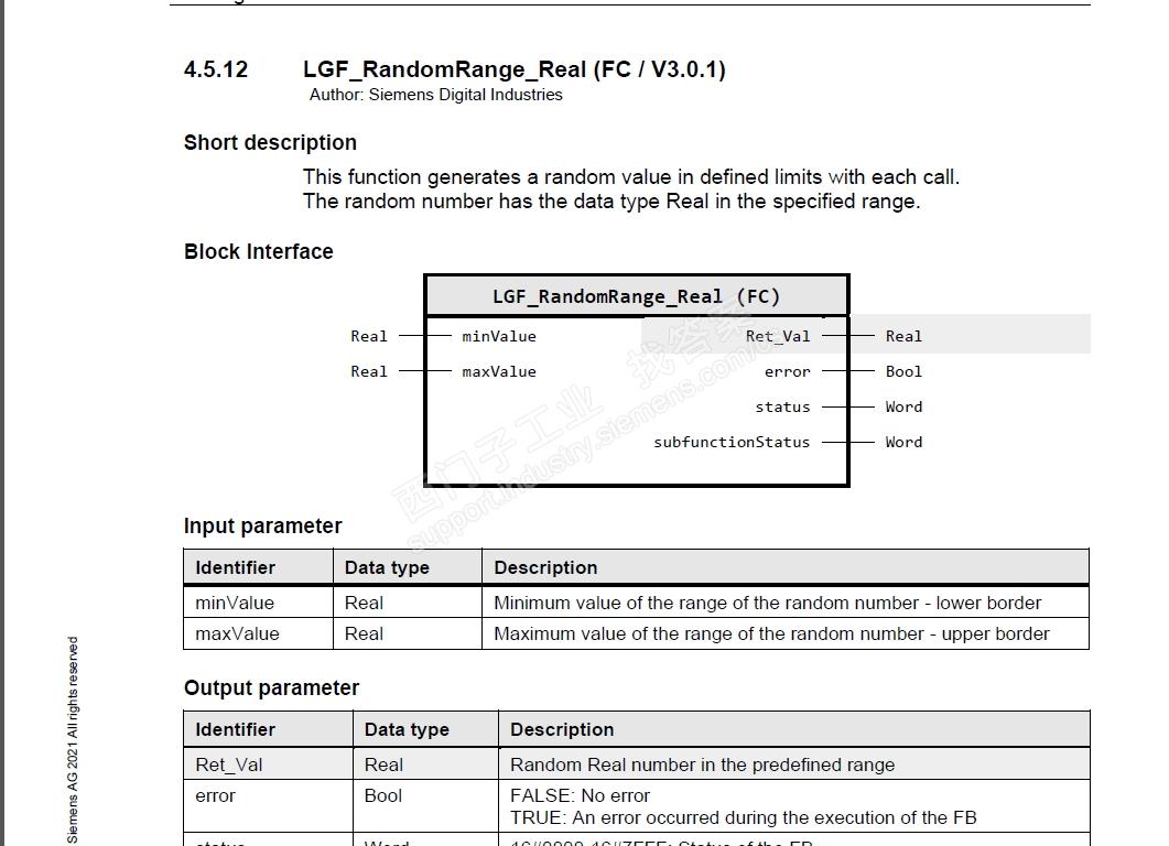

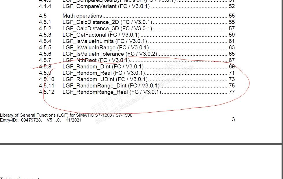

https://support.industry.siemens.com/cs/ww/en/view/109479728
官方有库
调用即可
TIA Package Manager - 下载全局库、示例项目和TIA插件
https://support.industry.siemens.com/cs/ww/en/view/109975682/zh
