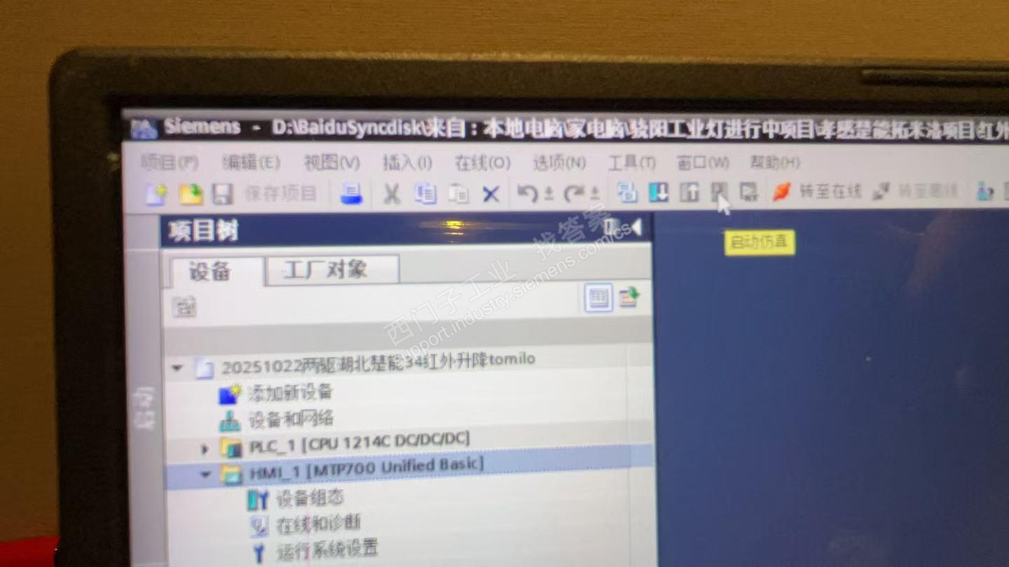

必须安装:
SIMATIC WinCC Unified PC RT (for simulating WinCC Unified devices)
SIMATIC WinCC Unified PC Runtime V19 仿真和试用版:
https://support.industry.siemens.com/cs/cn/zh/view/109820988
通信-仿真通信:
https://1847.siemens.com.cn/course/detail/1/18076/4892
