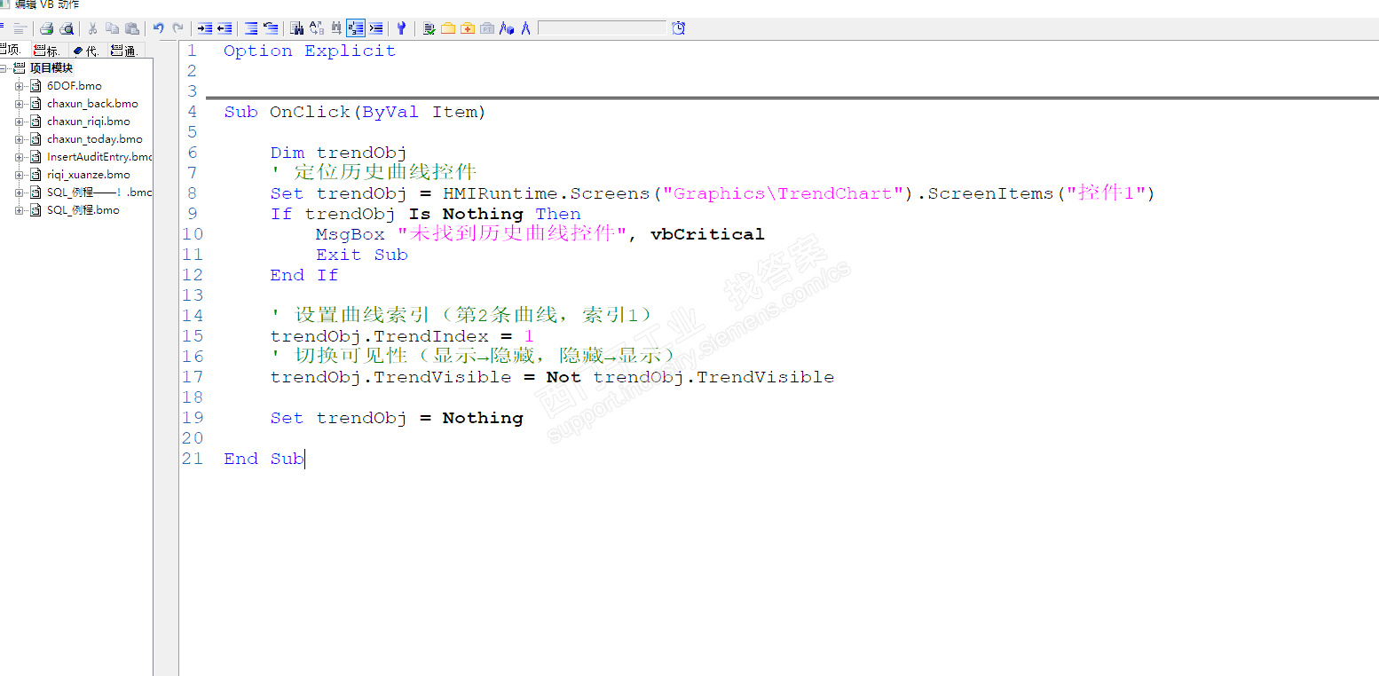

Set trendobj = HMIRuntime.Screens("MainPanel.display").ScreenItems("控件1")
