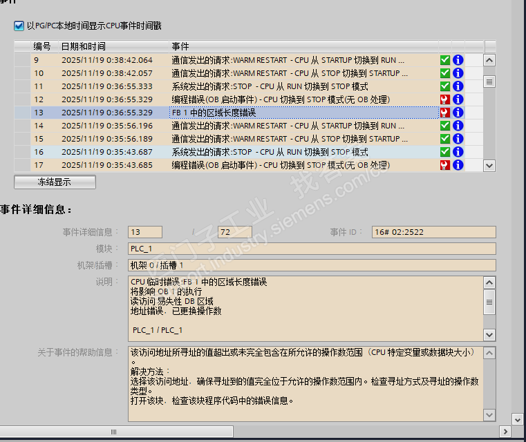

"DB_buffer".buffer[#buttonLoop+1]THEN#statTempZone:="DB_buffer".buffer[#buttonLoop+1]" />
