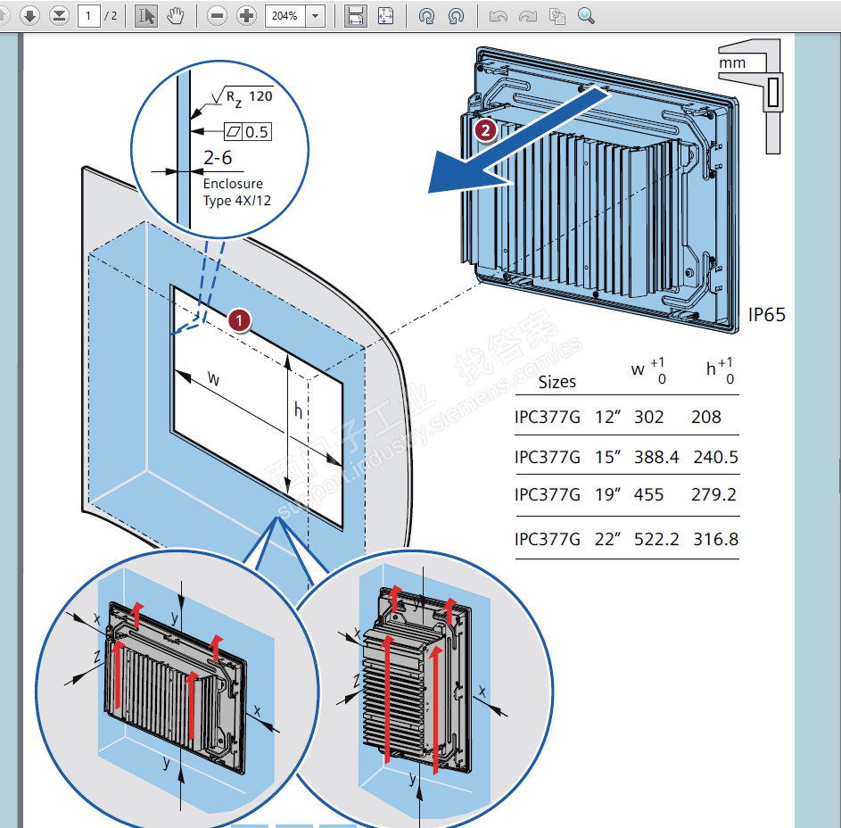

SIMATIC IPC377G Quick Install Guide
https://support.industry.siemens.com/cs/cn/zh/view/109976597
手册技术规范章节
https://support.industry.siemens.com/cs/cn/zh/view/109806084
