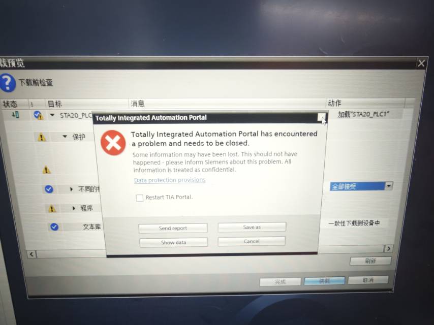

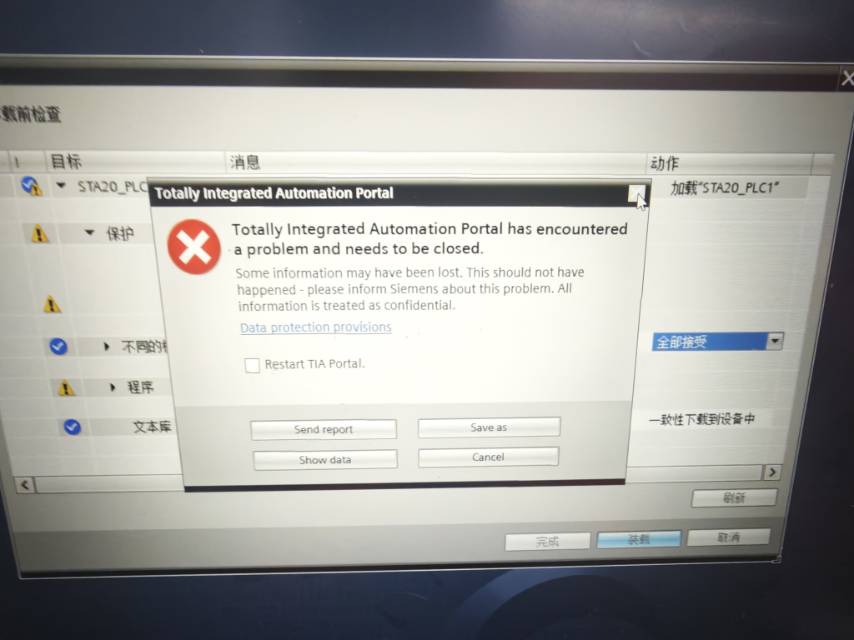

TIA Portal 在编译 PLC 时崩溃:(按照下面链接来,升级按安装最新V16的升级包就可以了)
https://support.industry.siemens.com/cs/cn/zh/view/109971630
STEP7 Basic/Professional and WinCC V16 试用版安装包(含 PLCSIM V16)
https://support.industry.siemens.com/cs/us/en/view/109772803
STEP7 Basic/Professional and WinCC V16 更新包(含 PLCSIM V16 更新包)
https://support.industry.siemens.com/cs/us/en/view/109775861
