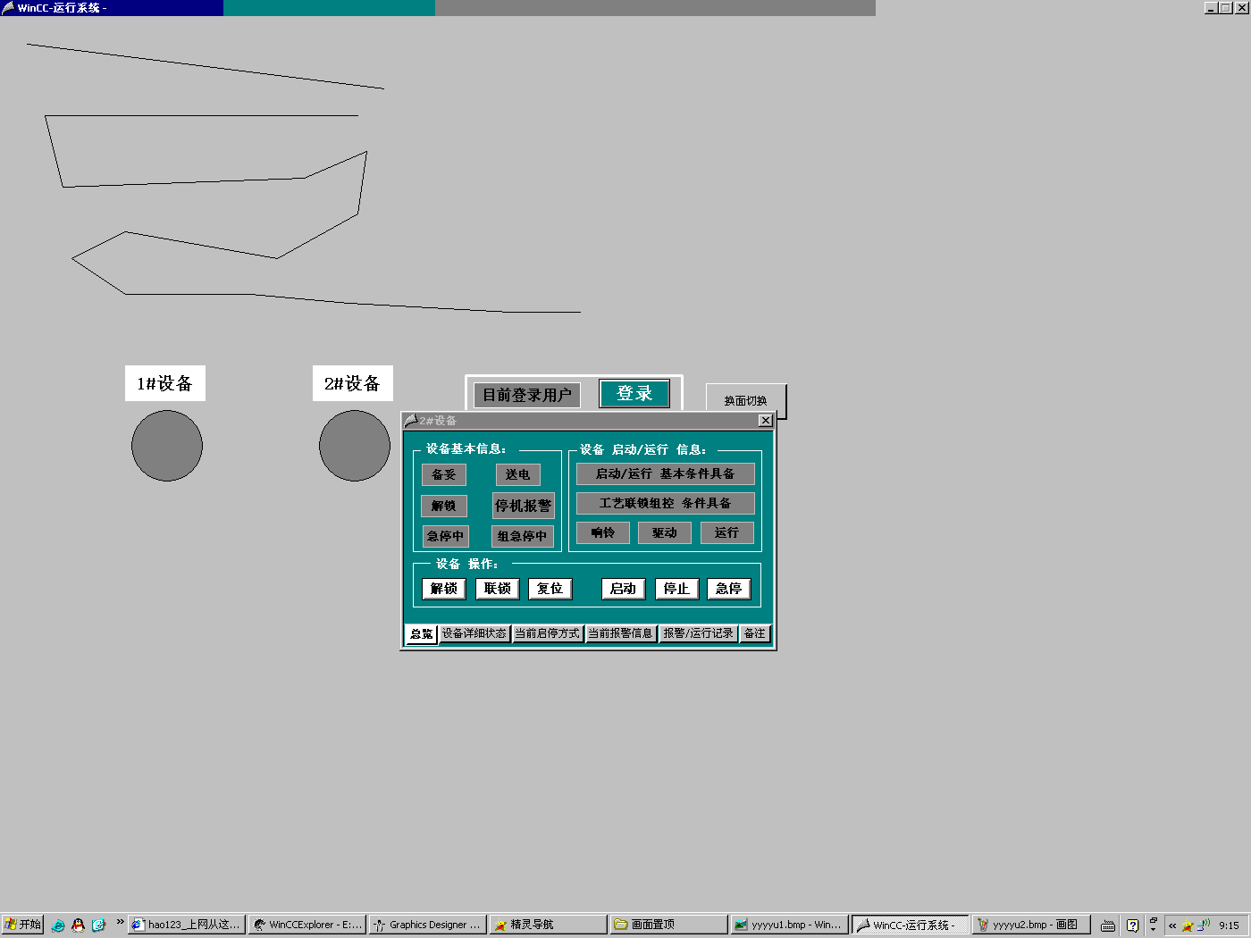

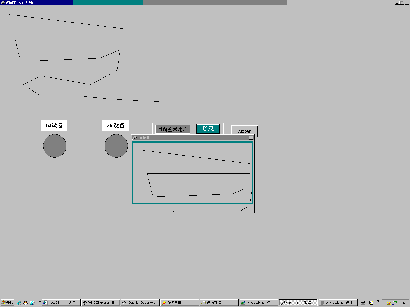

OpenPicturewindowoffset(lpszPictureName,lpszObjectName,"画面窗口1","test_con1.Pdl",0,0);
SetPictureName ("test_con1.Pdl", "画面窗口1", "con1.Pdl");
SetVisible("test_con1.Pdl","画面窗口1",1);
//SetPropChar ("test_con1.Pdl", "画面窗口1", "Tagprefix", "no1."); //Return-Type: BOOL
//SetPictureName ("test_con1.Pdl", "画面窗口1", "con1.Pdl");
SetPropChar("test_con1.Pdl","画面窗口1","CaptionText","1#设备");
