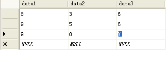

Dim Data1, Data2, Data3
data1=HMIRuntime.tags("DATA1").Read
data2=HMIRuntime.tags("DATA2").Read
data3=HMIRuntime.tags("DATA3").Read
Con="Provider=SQLOLEDB.1;Integrated Security=SSPI;Persist Security Info=False;Initial Catalog=读写数据库2;Data Source=.\WINCC"
Set conn = CreateObject("ADODB.Connection")
conn.ConnectionString = Con
conn.CursorLocation = 3
conn.Open
sSql="insert into dbo.data_test VALUES(''" &data1& "'',''" &data2&"'',''"&data3&"'');"
Set oRs = CreateObject("ADODB.Recordset")
Set oCom = CreateObject("ADODB.Command")
Set oCom.ActiveConnection = conn
oCom.CommandType = 1
oCom.CommandText = sSql
Set oRs = oCom.Execute
Set oRs = Nothing
conn.Close
Set conn = Nothing
End Sub
