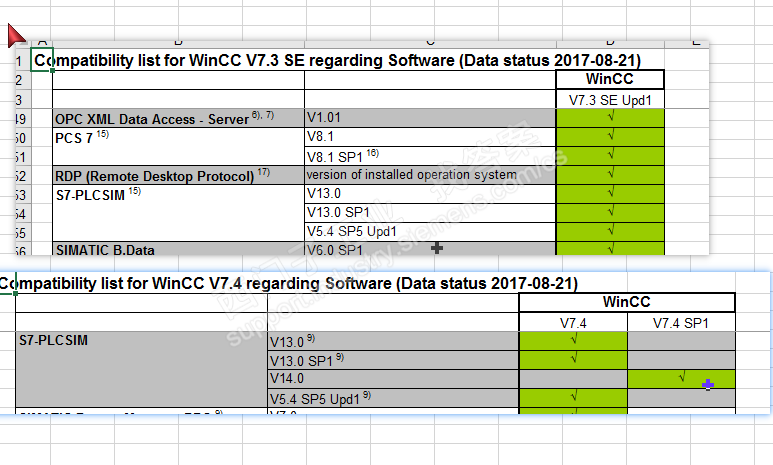

TIA V14 和WINCC V7.3不兼容的,需要WINCC V7.4 SP1版本才行~
可通过兼容性工具查询兼容性:
https://support.industry.siemens.com/kompatool/pages/main/index.jsf?sitc=wwdfi10002
