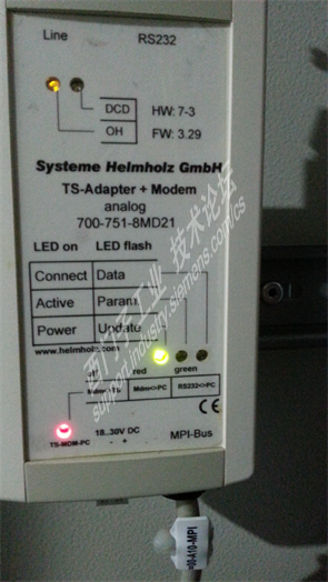

国外的机床带的 接PCU50的COM2 还有MPI线

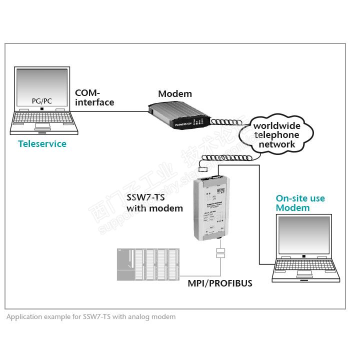

用于什么通讯呢
SSW7-TS, MPI adapter with Modem; analog/GSM
The SSW7-TS with integrated modem is an economical alternative for remote maintenance of an automation device via the MPI bus.
Depending on the version, an analog or GSM modem is integrated in the housing of the SSW7-TS. The analog modem can be configured for use worldwide. All connecting cables required for operation are included. For mobile use, or if there is no telephone line, the SSW7-TS with GSM modem (quad band) is the right choice.
Using the serial interface, the SSW7-TS with modem can also be used as a PC adapter for on-site use. The respective modem can also be used for remote maintenance of a VISU/SCADA application without the TS adapter function.
The SSW7-TS with modem is powered by the CPU via the MPI cable or external voltage connection.
The SSW7-TS with modem can be provided with new firmware over a modem connection using the free software SHTools. This means a functional expansion of an adapter already installed in the system is possible. The latest SHTools version is available for download at no charge at our website www.helmholz.com.
Accessories note
For the SSW7-TS with GSM modem, you need a Mini-SIM card with activated CSD (Circuit Switched Data) service from your mobile provider and a suitable GSM antenna.
