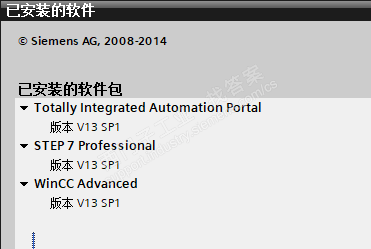

2、V13 SP1 已做好的软件可以升级,请参考
http://www.ad.siemens.com.cn/productportal/prods/s7-1200_plc_easy_plus/07-Program/01-operation/10-update.html
补充:
第二张图是提示
先安装 STEP7 Basic/Professional V13SP2 试用版安装包(含 PLCSIM V13 SP2)
https://support.industry.siemens.com/cs/us/en/view/109745155
然后再安装更新
STEP7 Basic/Professional V13 SP2 更新包
https://support.industry.siemens.com/cs/us/en/view/109759753
http://www.ad.siemens.com.cn/productportal/prods/s7-1200_plc_easy_plus/05-TIA/04-V13.htm
