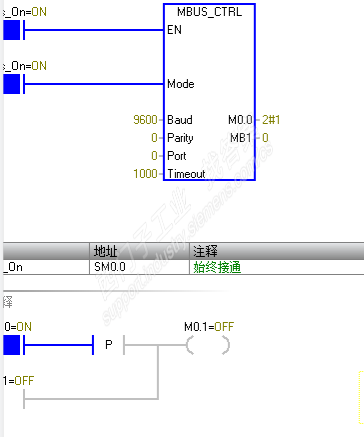

上升沿必须要检测到信号从0到1沿变,把上升沿段程序放在调用MBUS CTRL程序段前面。https://www.ad.siemens.com.cn/productportal/prods/s7-200-smart-portal/200smarttop/communication/serial_port/modbus/Master/Master.htm
