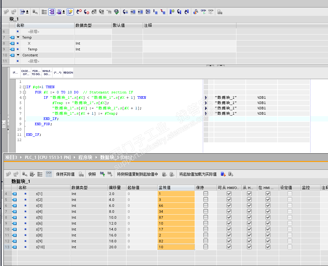

需要两重循环,代码如下
FOR #X := 1 TO 9 DO
FOR #Y := #X + 1 TO 10 DO
IF "SJ".S[#X] > "SJ".S[#Y] THEN
#TEMP := "SJ".S[#X];
"SJ".S[#X] :="SJ".S[#Y];
"SJ".S[#Y] := #TEMP;
END_IF;
END_FOR;
END_FOR;
测试图如下
