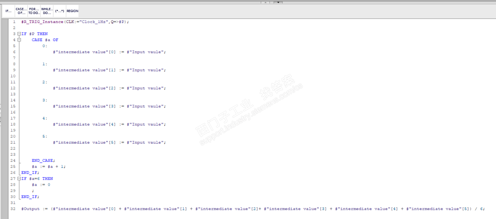

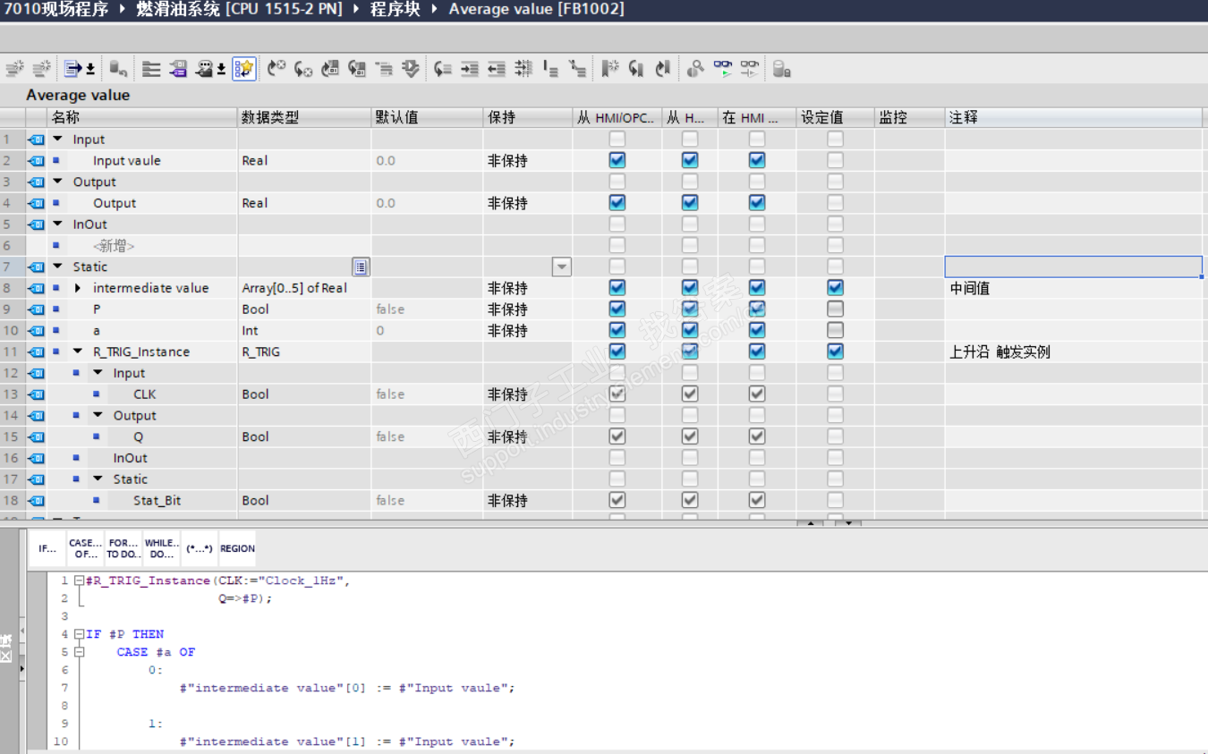

#P); 是什么意思?-#R_TRIG_Instance(CLK:="Clock_1Hz",Q=>#P);IF#PTHENCASE#aOF0:#"intermediatevalue"[0]:=#"Inputvaule";1:#"intermediatevalue"[1]:=#"Inputvaule";2:#"intermediatevalue"[2]:=#"Inputvaule";3:#"intermediatevalue"[3]:=#"Inputvaule";4:#"intermediatevalue"[4]:=#"Input" />
IF #P THEN
CASE #a OF
0:
#"intermediate value"[0] := #"Input vaule";
1:
#"intermediate value"[1] := #"Input vaule";
2:
#"intermediate value"[2] := #"Input vaule";
3:
#"intermediate value"[3] := #"Input vaule";
4:
#"intermediate value"[4] := #"Input vaule";
5:
#"intermediate value"[5] := #"Input vaule";
END_CASE;
#a := #a + 1;
END_IF;
IF #a=6 THEN
#a := 0
END_IF;
#Output := (#"intermediate value"[0] + #"intermediate value"[1] + #"intermediate value"[2]+ #"intermediate value"[3] + #"intermediate value"[4] + #"intermediate value"[5]) / 6;
