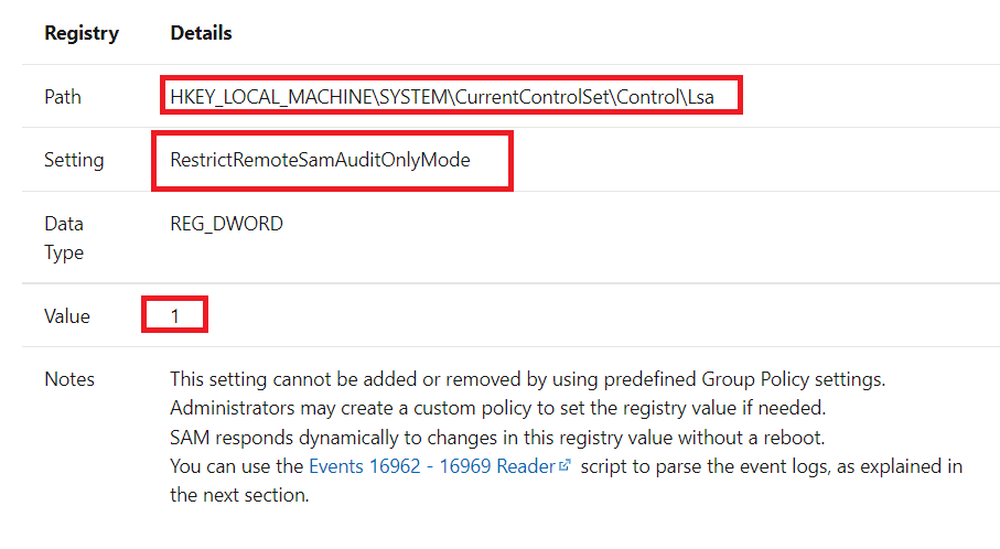

经查看手册发现:When using a central login computer in connection with a Windows workgroup, remote queries
of user, computer, and group information cannot be executed under certain circumstances. This
is the case if the role management of SIMATIC Logon does not list any users and groups after you
select the central login computer.
解决方法需要修改注册表,具体参考附件截图
