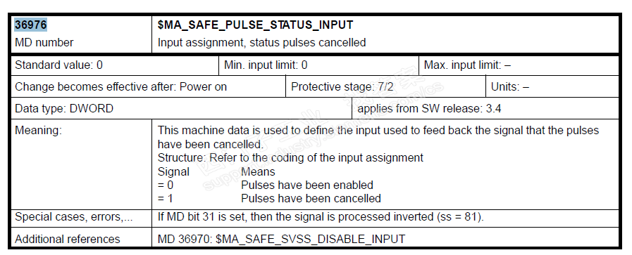

安全功能手册里
36976 $MA_SAFE_PULSE_STATUS_INPUT
MD number Input assignment, status pulses cancelled
Standard value: 0 Min. input limit: 0 Max. input limit: –
Change becomes effective after: Power on Protective stage: 7/2 Units: –
Data type: DWORD applies from SW release: 3.4
Meaning: This machine data is used to define the input used to feed back the signal that the pulses
have been cancelled.
Structure: Refer to the coding of the input assignment
Signal Means
= 0 Pulses have been enabled
= 1 Pulses have been cancelled
Special cases, errors,... If MD bit 31 is set, then the signal is processed inverted (ss = 81).
Additional references MD 36970: $MA_SAFE_SVSS_DISABLE_INPUT
