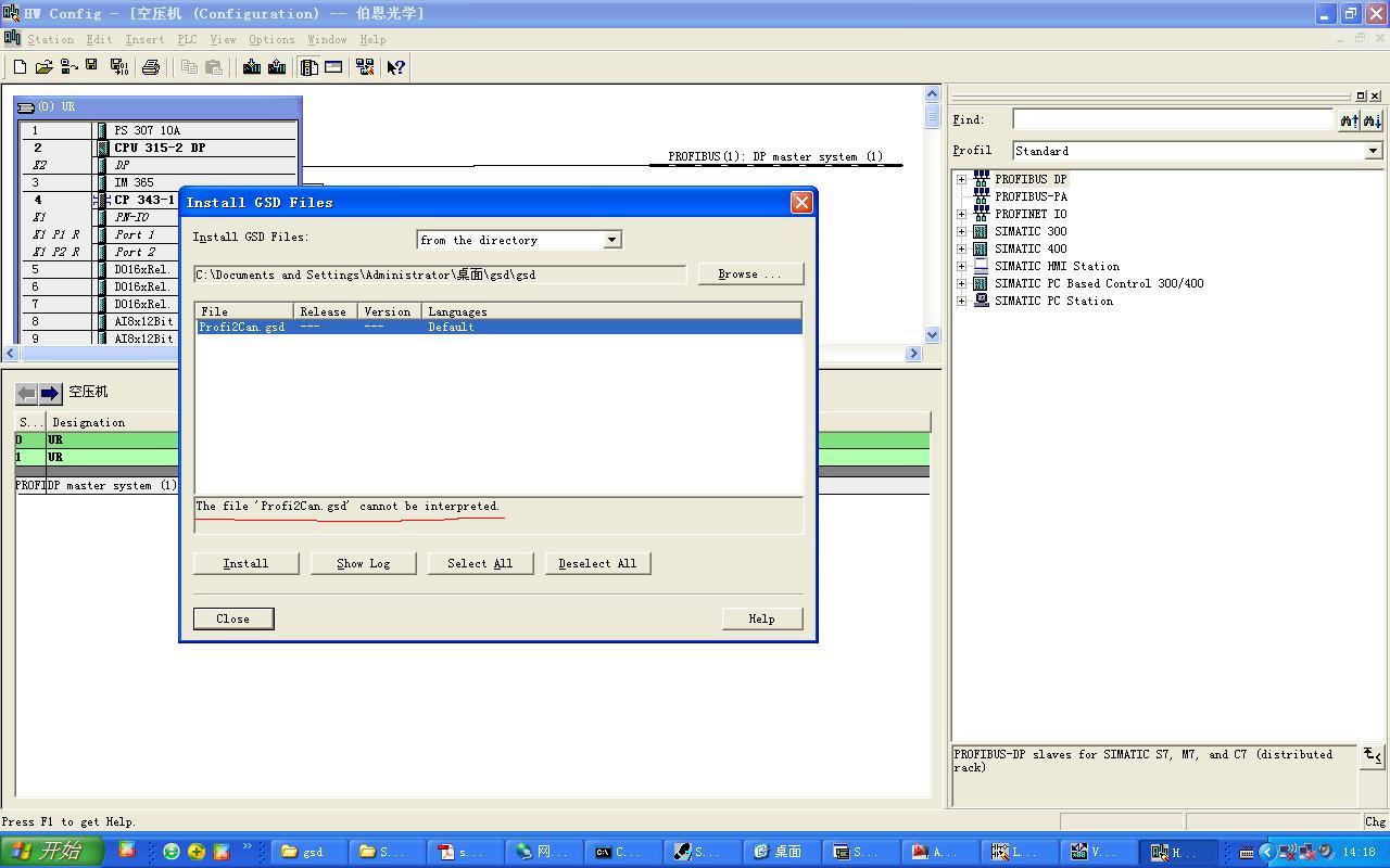

GSD installation
Beginning: 9/3/2012 2:21:39 PM
Source directory: C:\Documents and Settings\Administrator\桌面\gsd\gsd
Target computer: WWW-24AD5920122
User: Administrator
File: Profi2Can.gsd
Status: Not installed. Error while verifying GSD file.
S7HWCNFX.EXE: Install GSD File (13:4570): The name of the GSD file (type file) PROFI2CAN.GSD is too long. The name of a GSD file has a maximum of 12 characters.
