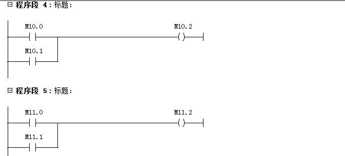

L W#16#200
O "M 310.1"
O "M 310.2"
JC M00b
L W#16#F00
M00b: T DB50.DBW 82
和
L W#16#200
A "M 310.1"
O "M 310.2"
JC M00b
L W#16#F00
M00b: T DB50.DBW 82
有区别吗?
